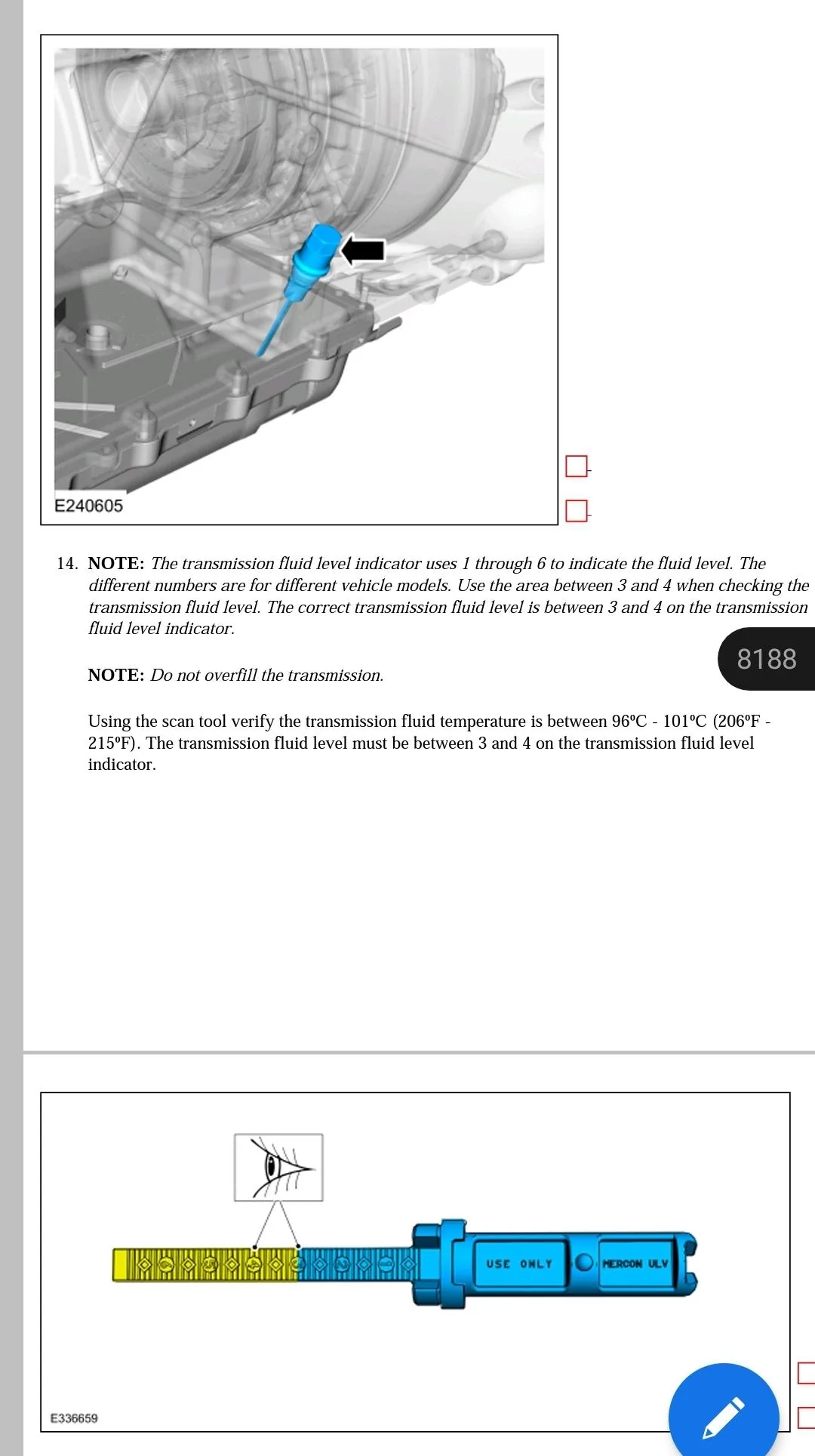

Holy crap they WAY overfilled it.. Supposed to be between 4-5 when hot.

At full temp, engine on, should be between 3&4

Thanks for posting this. I wasn't aware of any change in fluid level.
How can the actual dealer be this incompetent…?
Do you have a pdf of this actual spec that I can show the dealer, by chance?
No offense, but this forum is riddled with examples of the lack of expertise in the service department.
And the information that I posted above is from THE official manufacturer's service manual for your truck. Your dealership has the exact same documentation.
However, you get the feeling these days that they don't READ?
