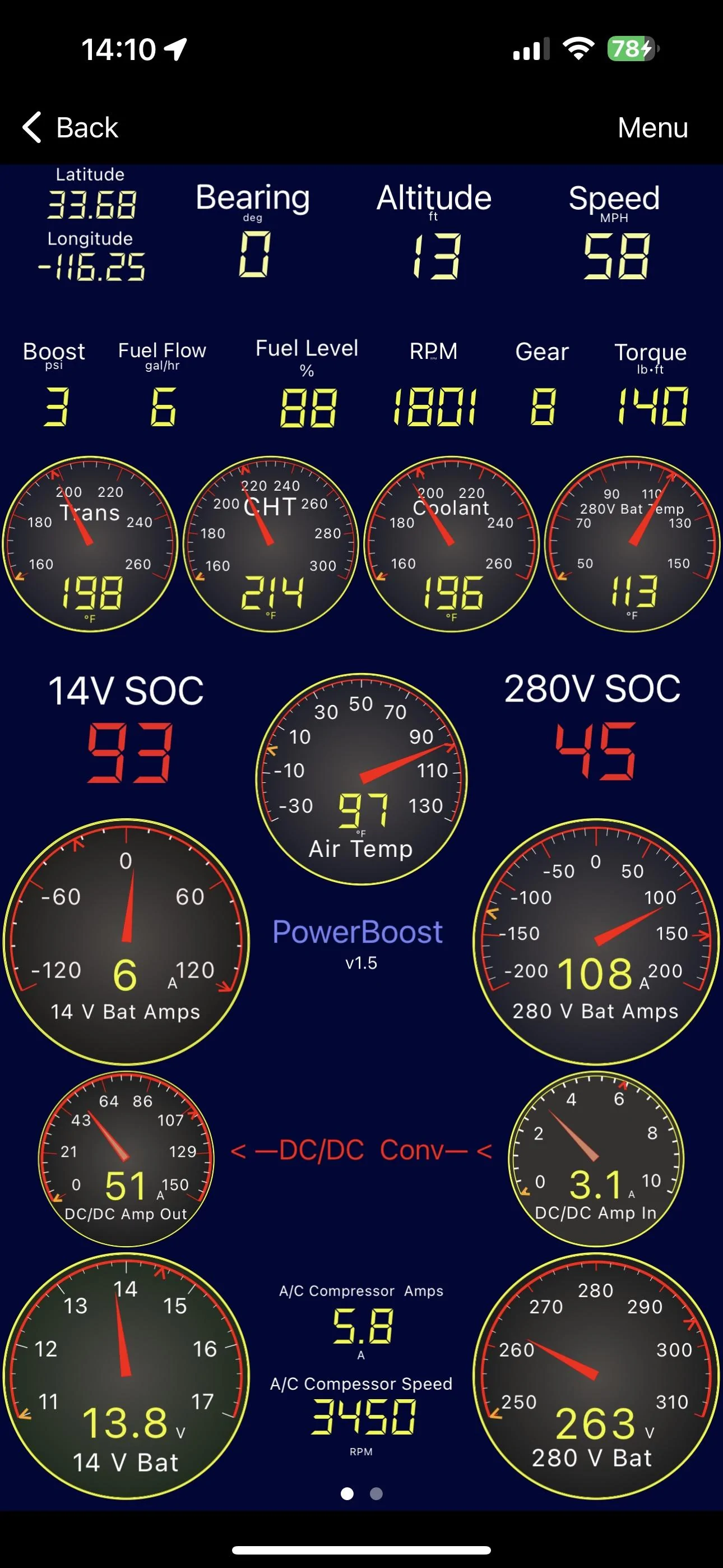

As @Snakebitten said that is the PID Easter Egg playground. Keep surfacing PID's until you fine one that is useful then move it to the front page dashboard.
I am still working on v1.5.
Ford F-150 PowerBoost 1.5 - We Need More Than Idiot Lights v1.5
Version 1.4 below is still current. As always suggestions are welcome.
Ford F-150 PowerBoost 1.5 - We Need More Than Idiot Lights v1.4

Ugh. I cannot get away from meetings today..
But I have been playing with the app during them.. :D I removed Lat/Long, Bearing and Altitude, as I generally know where I am, and Florida is pretty flat anyway.
I did add OAR though, as that seems like it might be handy at times.
I find altitude pretty funny. The only point of it that truly matters is the distance from the road to the tires and if that value is anything other than 0, ain't no gauge going to save ya and you're in big trouble.

The reason the geo-location data is there is to correlate time and place to a screen capture shot of an unusual presentation.
As to altitude as a "funny" variable, I invite you out to my playground in the West ranging from -120 MSL up to 13,500 MSL. You will see a PowerBoost with many different presentations depending on density altitude and temperature. For instance, pulling a heavy trailer with density altitudes well over 14,000' with unusual heat, places stresses on the systems you will never see in Florida.

Fair points. ?
The man was born with altitude, longitude, and latitude coded in his DNA.
Destiny, in fact.

Screen shot right now. Car is sitting in Thermal, CA at -103 MSL. The altitude is accurate and it definitely impacts the performance of not only the ICE but all the cooling systems on board. The ICE and some of the thermodynamics of these cooling systems is much more sensitive to temperature adjusted altitude of your current location, that is called density altitude. As a matter of fact we really should have a calculated PID for density altitude rather than actual altitude in the OBDLink dashboard. @Snakebitten do you know how to do this?
Here is a density altitude calculator.

Yeah, gale banks is always ranting about getting rid of boost gauges for air density. Variables on heat dissipation go out the window at altitude. Crazy just how much rad performance is lost up there.
