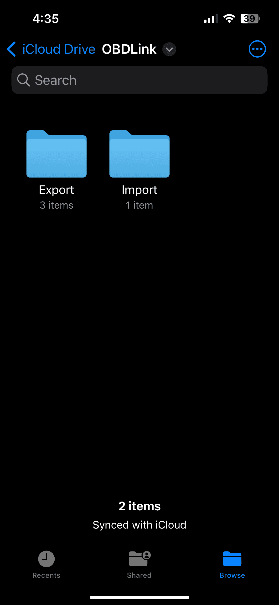

If you're using iCloud, it will create a folder structure - drop the .stg file into the import folder.
Ford F-150 PowerBoost 1.5 - We Need More Than Idiot Lights IMG_2837
You should be able to import at that point.

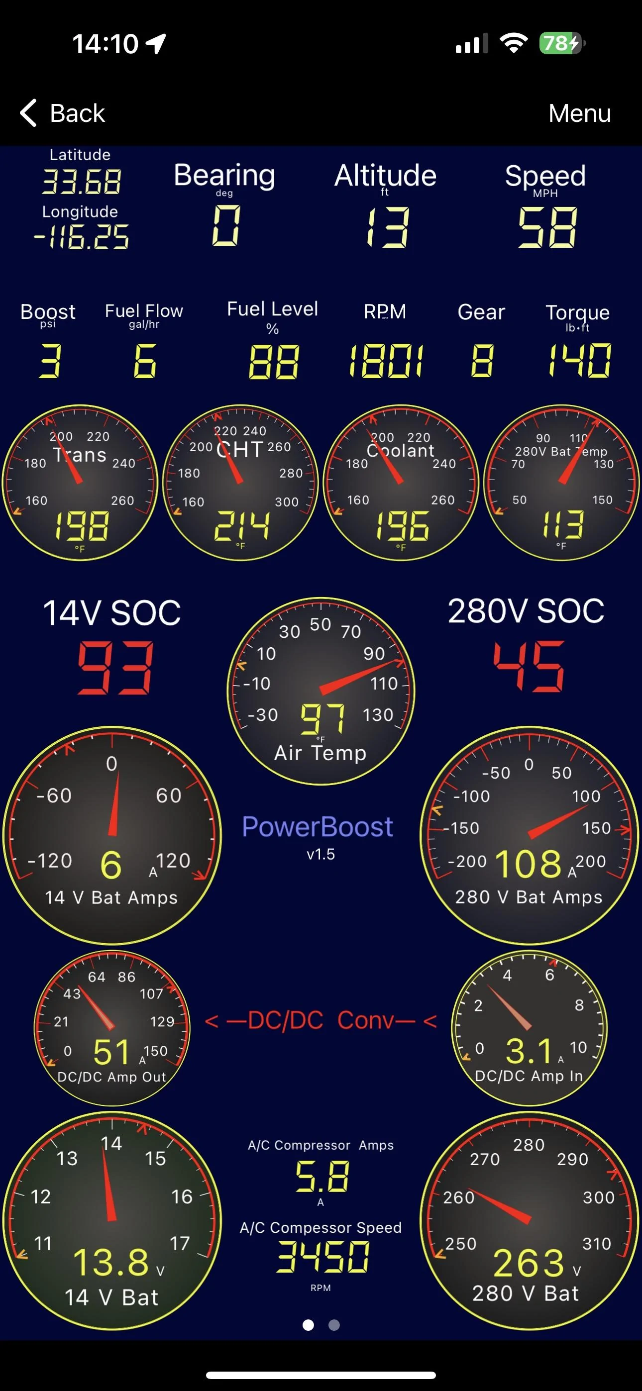

I duped @turbopilot PB1.4 and changed the colors to what I see as matching my 8" dash in Normal driving mode. Here it is for you Droids like me. Don't forget to rename to .STG.
If you wanna use true Ford vehicle colors, check out https://encycolorpedia.com/c8bfb9 .
Ford F-150 PowerBoost 1.5 - We Need More Than Idiot Lights Example Screenshot

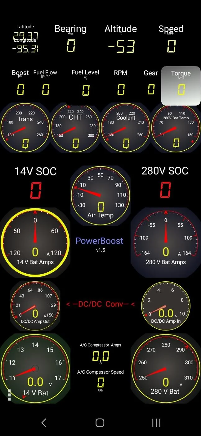

A question for you gurus of OBD, if you don't mind. I've imported a couple of different dashboards thanks to @turbopilot, @Snakebitten, and @ReverendQ (!!) and each one has several of the readouts (pids??) with no data displayed. Is this something I'm doing wrong during the import files process or something else?
Ford F-150 PowerBoost 1.5 - We Need More Than Idiot Lights Screenshot_20230916_142932

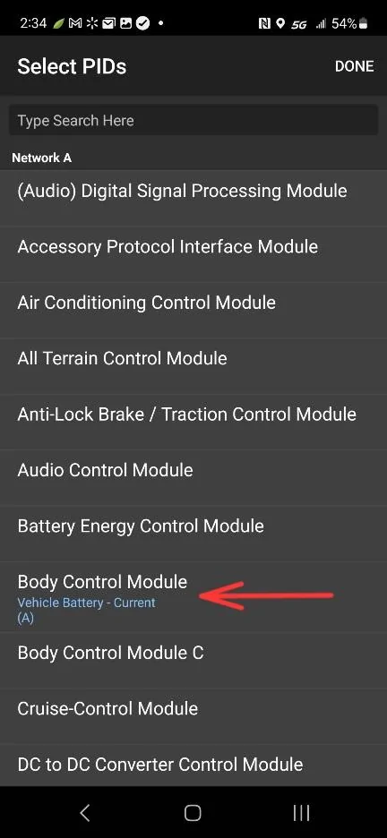

That will get you to the correct module that hosts the PID. Press it
Ford F-150 PowerBoost 1.5 - We Need More Than Idiot Lights Screenshot_20230916_143414

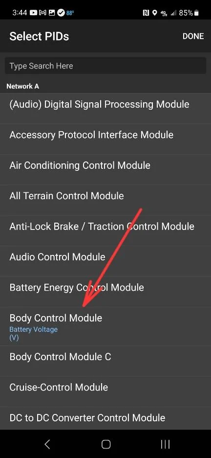

So if you are trying to map a gauge called "Battery Voltage", and it's the Low Voltage (12V) battery, you should see if you can drill down to this:
Ford F-150 PowerBoost 1.5 - We Need More Than Idiot Lights Screenshot_20230916_154417

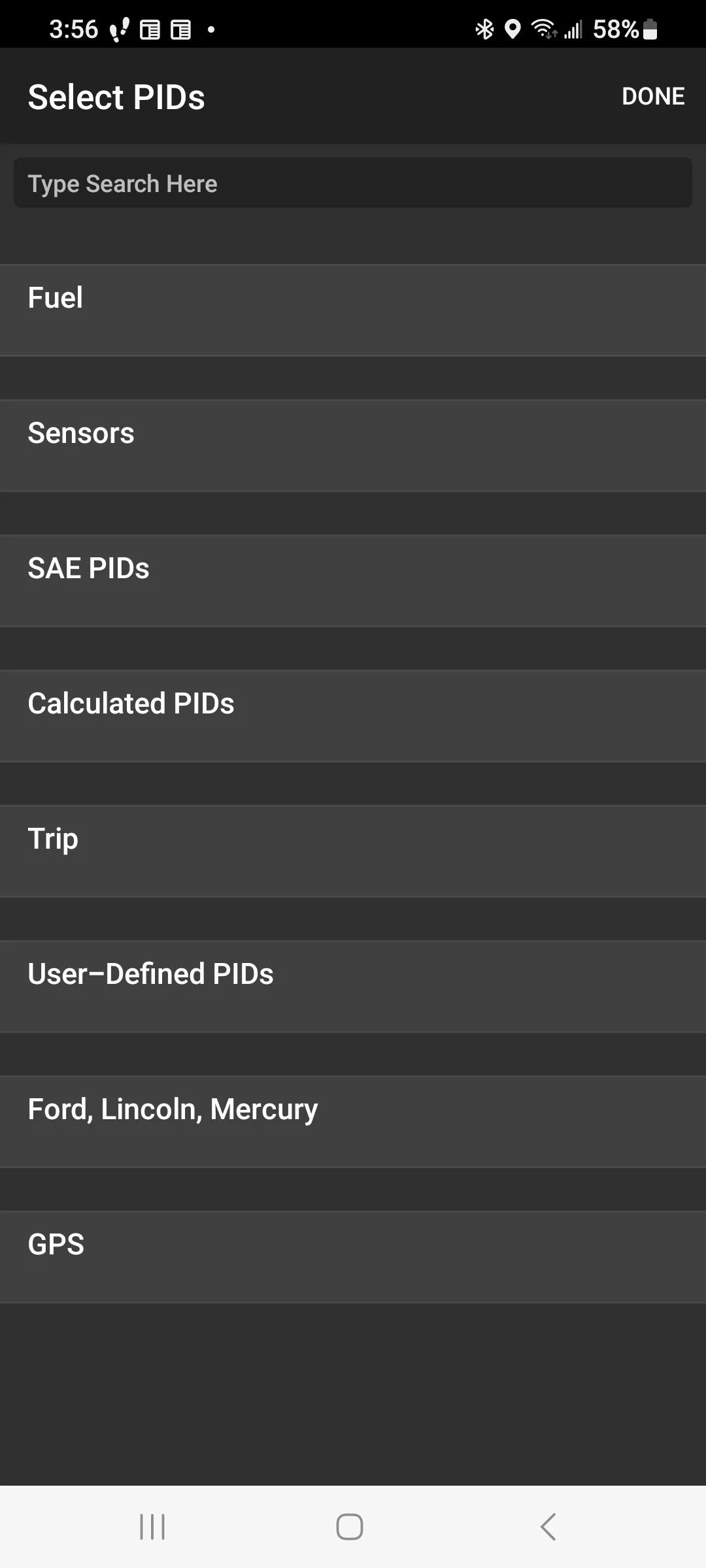

Then select Ford/Lincoln/Mercury even if there's nothing in blue preselected
Ford F-150 PowerBoost 1.5 - We Need More Than Idiot Lights Screenshot_20230916_154430
Then select BCM
Ford F-150 PowerBoost 1.5 - We Need More Than Idiot Lights Screenshot_20230916_154439
Then select Battery Voltage and "Done"
You just mapped the gauge to the PID you desired it to monitor
Ford F-150 PowerBoost 1.5 - We Need More Than Idiot Lights Screenshot_20230916_154449
