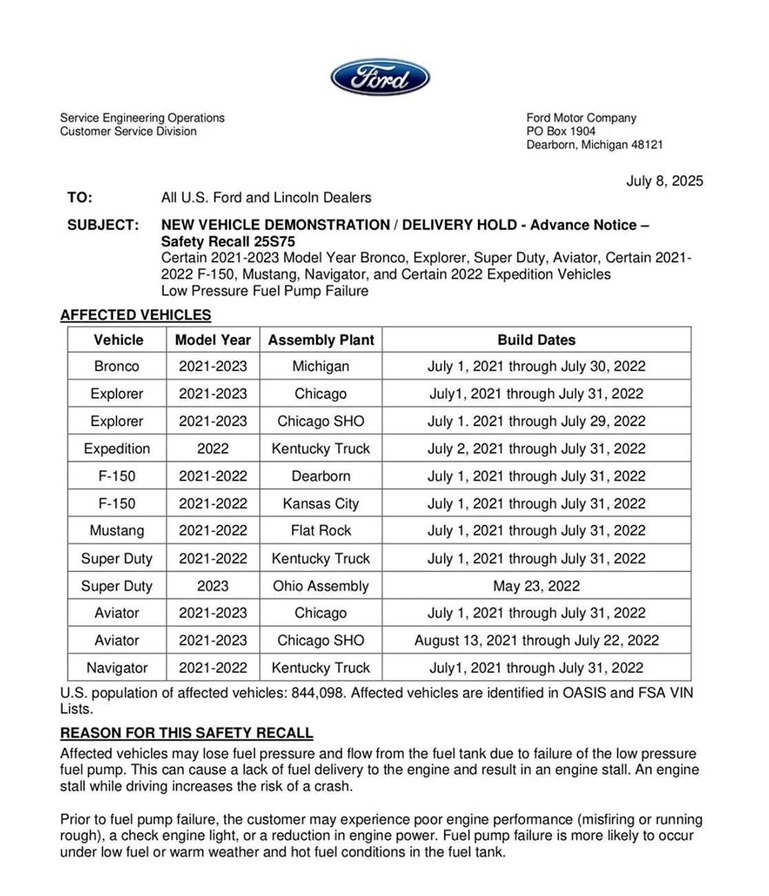

I guess it sometimes pays to be an early adopter, my 21 job 1, production date of June 26th, 2021 does not fall within the time frame. Supposedly , the recall affects July 1, 21 and later production.

I've got in on FordPass and NHTSA. Strange that thye don't have a fix but state that 10% of recalled vehicles will experience the issue. Probably figuring out how to close the recall without really changing anything. I've seen that before with Ford.
Ditto, good to be a job 1 truck for once.

Peak Covid. Shit was going to happen. 8.9 vehicles per 1000 is 0.9%, not 10%.

The Ford recall on page 1 does say that up to 10% of the listed vehicles could be affected. But on one of the last pages it also says the failure rate is 8.9 per 1000 vehicles by the 150K miles/10 yr point. Maybe how to read this is: of the ~455,000 F150s that could be affected, only 10% will have the faulty pump, and of that 45,500 trucks, only 8.9 out of 1000 will have the issue by the 150K/10yr point, so this could be as little as ~400 total F150 trucks that ever experience the issue If nothing was done to fix it. Ford math could be different than this, who knows.

So I got the notice in my Ford Pass as well. = I thought I was a Job 1 build (outside of date range, but perhaps not), I will have to look for frame sticker, but I got Ford Pass, so I may have issue right?
Also I saw here: https://fordauthority.com/2025/07/850k-ford-motor-company-vehicles-recalled-over-faulty-fuel-pump/
Number of vehicles affected: 850,318 total possible - 10% is 85,031 across all product lines,
Ford Motor Company is recalling select 2021-2023 Ford Bronco, Ford Explorer, Lincoln Aviator, Ford Super Duty F-250, F-350, F-450, F-550, 2021-2022 Lincoln Navigator, Ford Mustang, Ford F-150, and 2022 Ford Expedition models over an issue with the fuel pump.
But since they make more F150's than any other type, I figure %5 F150s? = 42,515 F150's total that might need the repair?

So some truck are affected, and some aren’t.
I guess that the factory had multiple suppliers for the pumps. Only one supplier had the the defects?
I read it the same: 10% of the vehicles will have the suspect pump, of which about 10% will fail. Will be alot of other failures on and f150 by 150K. At least the fuel pump will be covered by a recall :) :)
