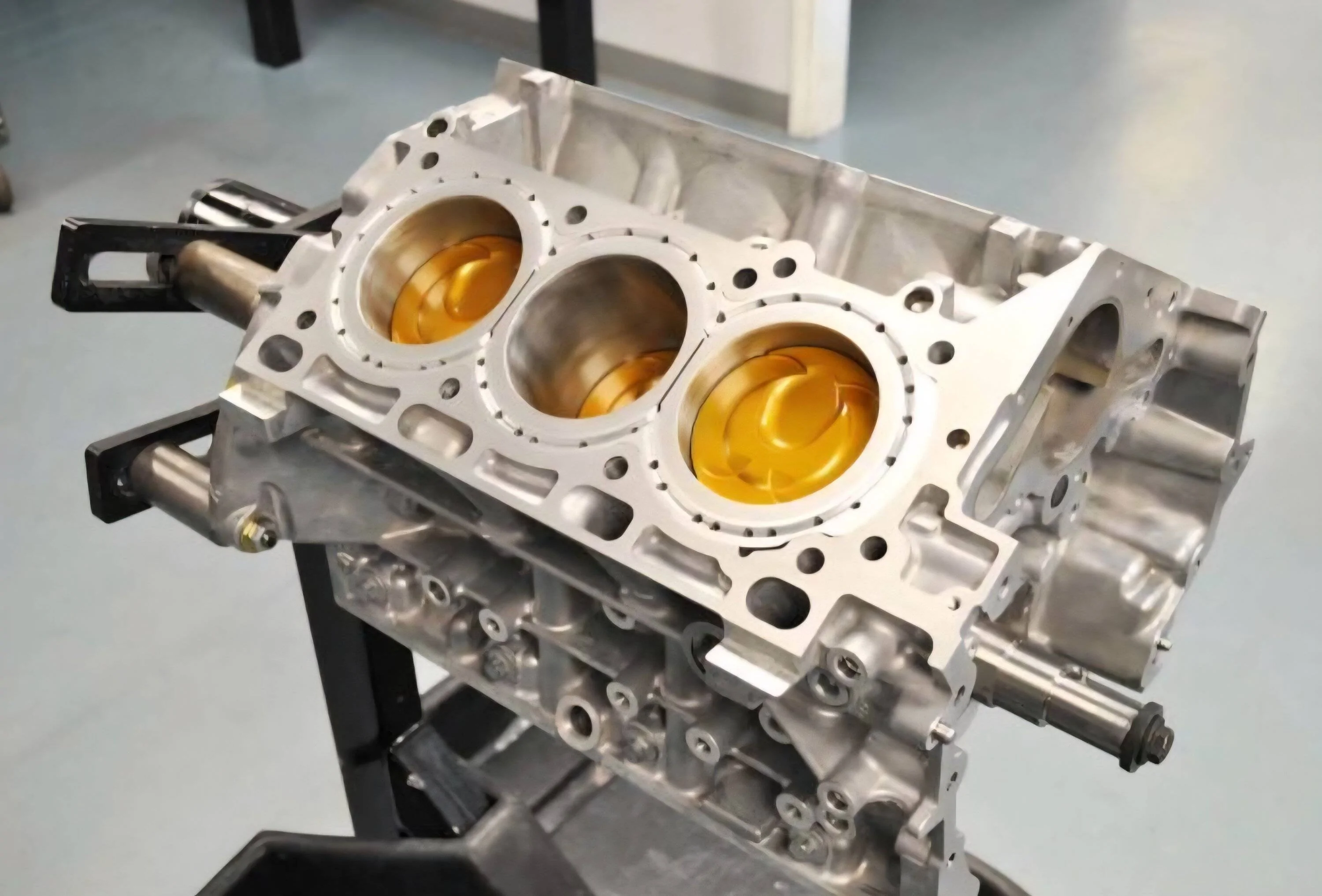

I hit 685whp and 778wtq on the stock engine with CRP Stage 5 turbos, port injectors, and a Livernois Custom Billet Dual pump system...
Fyi..Stock is 385whp and 500wtq.
...but it wasn't enough, so a week later I drove back to Livernois, and parts have been coming in.
I am having Livernois Motorsports build me their Race Series engine..?
Race heads, Diamond Pistons(coated and heat treated), Mahle Rods, Deck Brace, Sleeved, blah blah blah...
With my 50shot of Nitrous, It's gonna be spicey!
Goal is 700-750whp on fuel, and 850-900whp on spray..
....I may bump it up to a 100 or 150 shot..??....which would be around 1,000whp..
Having custom wheels made so I can get the power to the ground:
(2) 18x10 +30 offset
(4) 18x11 +40 offset
I had SP2 design me some custom wheels, to kinda look like my stock Sport wheels, to keep the sleeper look(Wheel rendering attached)
Two of the rears wheels are for my 325 45 R18 Hoosier DR2 Drag Slicks I already have..
..the rest of the wheels are for either Toyo Proxes STlll or some Nittos....because I tow, and need daily tires.
Red Rocket is gonna hurt some feelings...?

Sort of an off thought, have you considered getting the major parts (block, crank, rods, pistons) cryogenically treated? It's not snake oil, though it's not a miracle solution either.
Yes, and yes some of the parts are getting ceramic coated and heat treated.
