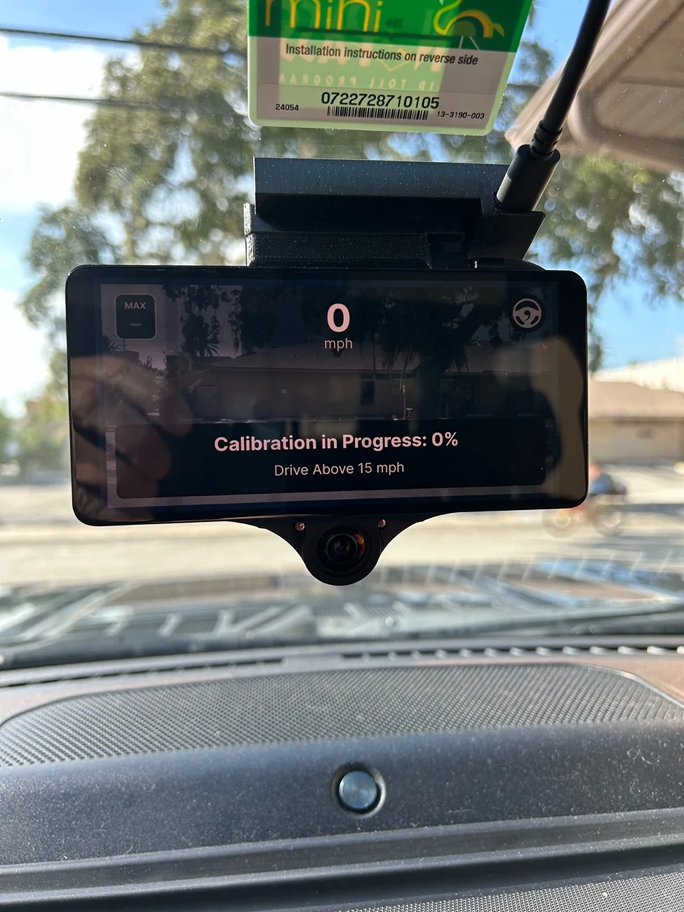

Latest update on my situation. I checked for updates and once those were installed the FoF Liquid Crystal installed completely. It "strongly recommended" that I recalibrate so I attempted to do that. Unfortunately, it never moves past 0% while I drive. I then tried installing the version 16 of Tomb Raider which also installed but wouldn't calibrate past 0% either. In frustration in installed the default model, Tomb Raider 14 and it won't calibrate either? I'm thinking at this point I need to reset my Comma 3X and uninstall SunnyPilot and start from scratch again?

Latest update on my situation. I checked for updates and once those were installed the FoF Liquid Crystal installed completely. It (strongly recommended" that I recalibrate so I attempted to do that. Unfortunately, it never moves past 0% while I drive. I then tried installing the version 16 of Tomb Raider which also installed but wouldn't calibrate past 0% either. In frustration in installed the default model, Tomb Raider 14 and it won't calibrate either? I'm thinking at this point I need to reset my Comma 3X and uninstall SunnyPilot and start from scratch again?
No, I've seen this before.
something is still not right. It fetched the model list properly but failed to install it properly. Let me keep working on it.
