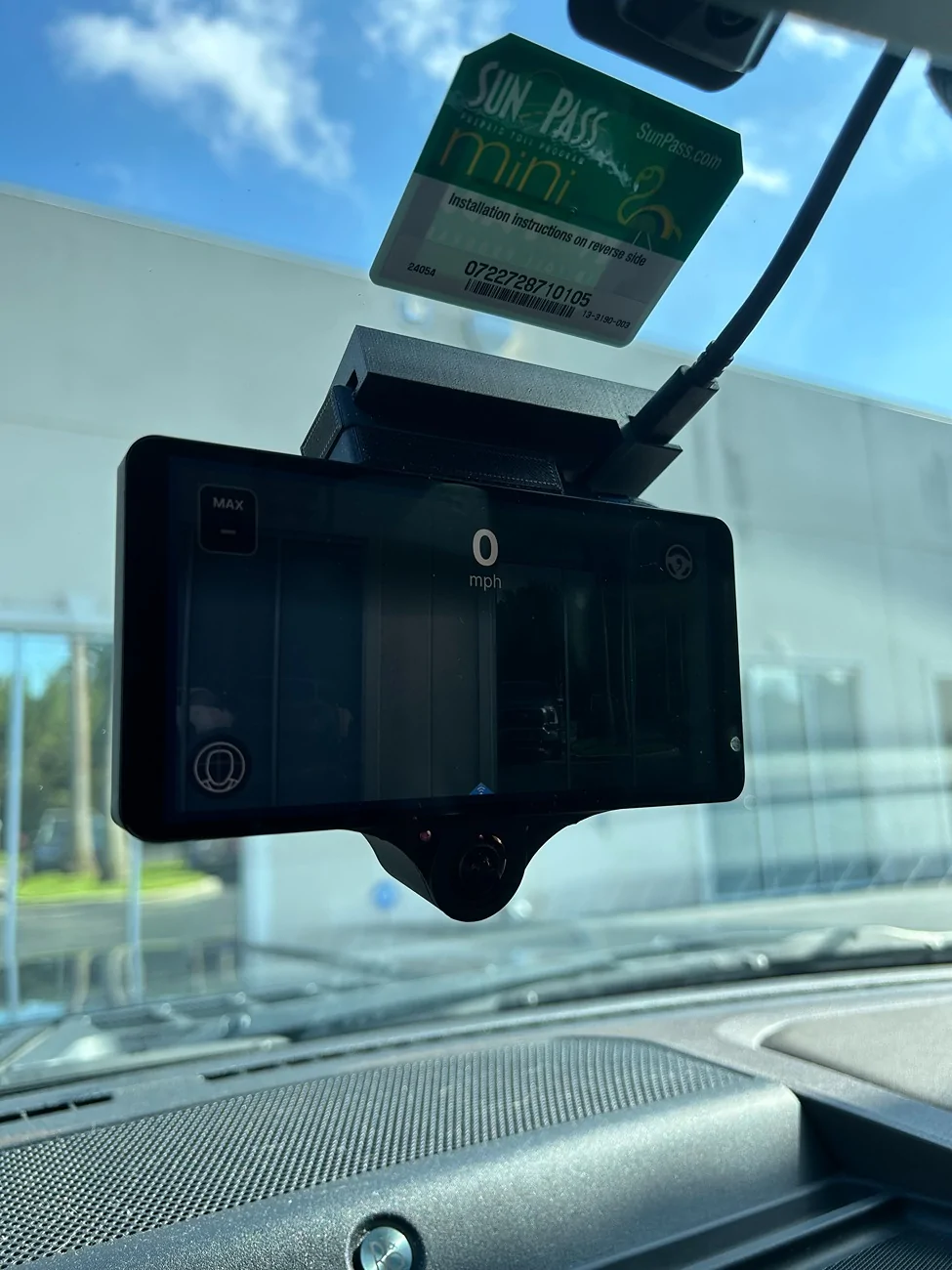

I just purchased and installed my 1st Comma 3X on my 2022 Ford F-150 Powerboost yesterday. Alan at ajzride was an enormous help, I really appreciated it. I also purchased one of his mounts, it looks and works great (Pic attached). I installed the latest bp-4.0 and it works really well but I've put about 200 miles on it and am getting the radar errors occasionally. I tried to install the Filet o Fish Liquid Crystal model but I can't install any other models. The default model Tomb Raider 14 also has the select button beside it greyed out. I'm hooked to good wifi but when I hit the refresh model list button it says "fetching latest models" but nothing happens. Sorry, I'm new to this, am I doing something wrong? Here are the images of what I'm seeing. If anyone can help it would be very much appreciated.
