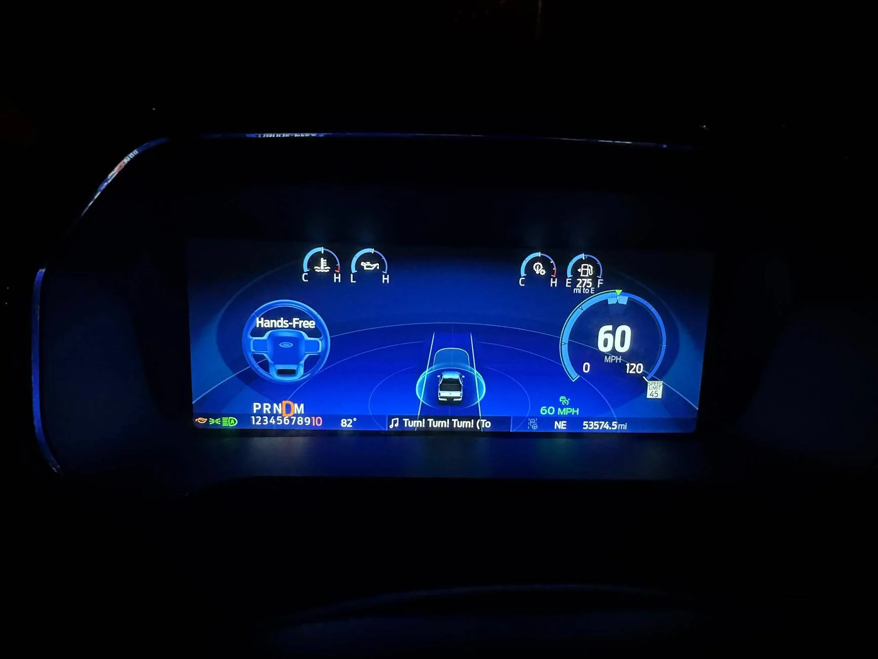

I switched from BP3.0 to BP2.1 and these settings really helped me get quickly up and running, but there were a couple of items that I'd like to change. 1st is that speed sign recognition does RECOGNIZE the speed limit changes, but no adjustments are made based on the change in speed limit. I checked, and in the truck's settings, speed recognition is still checked and a 5 MPH tolerance is still in place, but it is as if the truck is ignoring this setting. Second, my dash was replaced by a very different appearing dash...1st image is how it was before, implementing the above settings changed things. Of the settings that are posted, which ones might I be able to change to give me back speed sign recognition with appropriate set speed adjustments and can I revert back to the stock dash gauge arrangement. I liked how changing driving modes made slight changes, such as the truck's color changing depending on which driving mode was selected, (eg. the truck being green when ECO mode was selected). I wish I had taken screenshots of how my settings were BEFORE making the adjustments, but since I didn't, hoping there is something that will restore the speed sign recognition with the adjustment and put the dash back to more stock-like, but otherwise keep the rest of the settings (would really like my tach back).
The setting is literally called "show hands free UI". Turn that off.

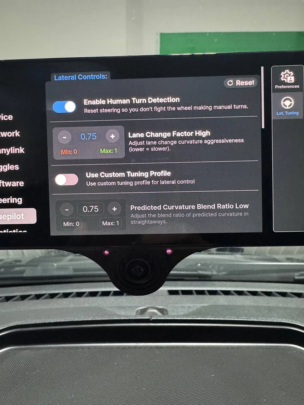

Any suggestions on the best tuning parameters to remove or severely reduce ping-pong(ing)?. I have been messing with the tuning for the last 4 days and still couldn’t get it to stay in center, at least for more than a mile. Curves are no issue; tangents ARE the worst. Any help, as always is GREATLY APPRECIATED!

To add, I found turning off Custom Tuning and Advanced Lateral Control to be a bit better.

Can you upload a route? I added instructions to post 7.

Your PC Blend Ratio is way too high. Turn it down to around 0.4-0.6. Turn off Advanced lateral. Once you get things decent without advanced lateral, you can turn it back on. Set path angle amplitude to 1.2 and slowly work up, dont go above 1.8.
