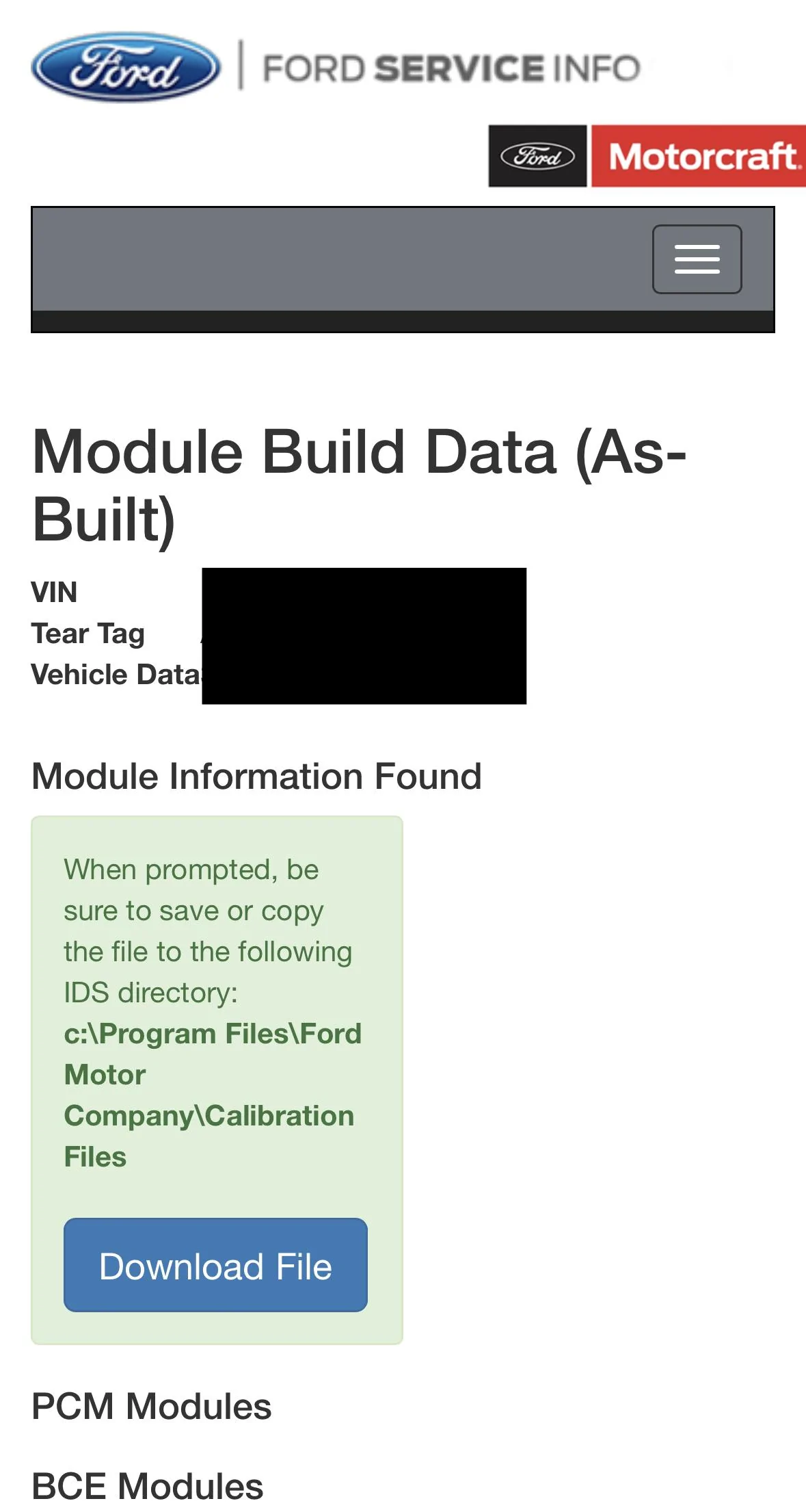

I should also add that the reason I’m asking is I’m not sure if downloading the AsBuilt from Motorcraft is downloading the ORIGINAL AsBuilt or whatever the latest AsBuilt that was backed up during OTA updates.
@Jesse-Infotainment ?

The download will be your latest version, there is no way to differentiate changes that were made by a previous owner in forscan verus changes that were made by ota and fdrs. The motorcraft site contains the last known functional version. And can't look back.
