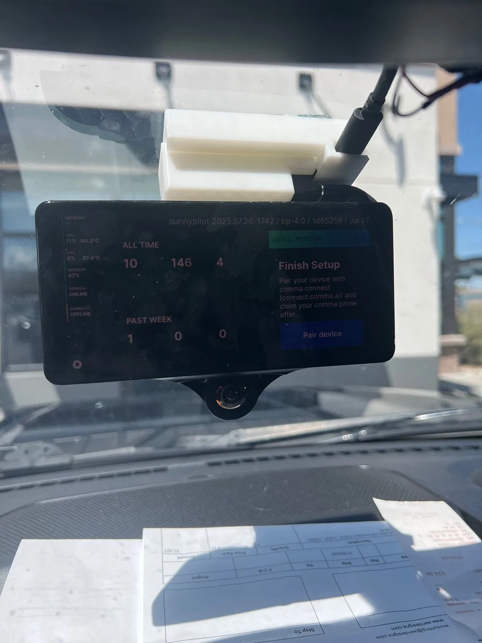

So I’m guessing this is a Sunnypilot thing but I noticed the stats don’t seem to be capturing my drives. Kinda hard to see but shows only 146 miles. I did 300 the other day and 500 today.
The data comes from the server, not the device. You "connect offline" means it's not reporting back to the server. Once you get on wifi for a few hours it will sync up.
If you go too long between wifi syncs, it might have overwritten data that will never make it to the server. Generally the comma holds about 4 hours of data.

Gotcha, that makes sense. I’ve been avoiding WiFi due to the Sunny update and won’t be back for a few thousand miles.
I drove from Dallas to ABQ today and it performed like a dream. Only had to take control a few times the whole drive on really sharp turns, but that was probably more a function of my speed than the curve.
Yea, I'm assuming you are running 80-90mph (at least) on that stretch. You run into the ford safety limits pretty quick at those speeds.
