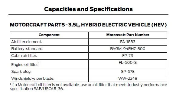

My 2024 PB has a H7 battery. There does not appear to be enough room to install an H8 battery. Is there a change from earlier PB that no longer makes installing an H8 in a PB feasible? Can you still use an H8 in a 2023 PB?
From my understanding no Pb from any year can use an H-8 battery due to the modules attached to the battery tray. I don't have one, but I have been on this forum since July 2021 and that has been the talk all along. Sorry.

The powerboost was never able to fit an H8 with all the extra magic stuff in there. I believe they used to come with an H6 from the factory
