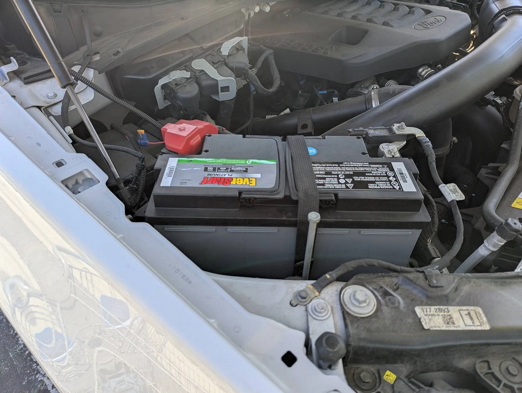

Bought an H8 at Walmart yesterday and changed it in the parking log. No issues with cables or fitment. As others have said, it appears the tray was designed for this battery, and Ford realized they could save $7 per by putting in the H6.

Walmart H8 is 13.9 x 6.9 x 7.5 900 CCA
Walmart H7 is 12.4 x 6.9 x 7.5 850 CCA
Walmart H6 is 11.9 x 7.5 x 7.7 760 CCA
When I measured the tray on my 21, there was 14 inches available.
