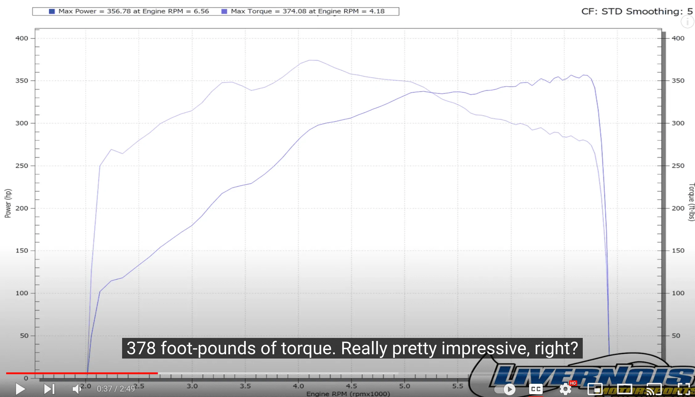

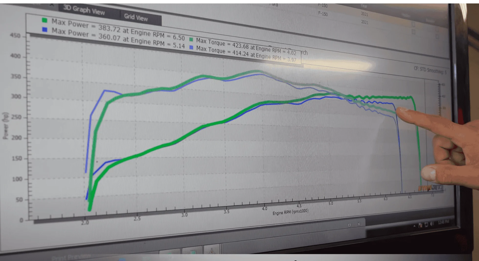

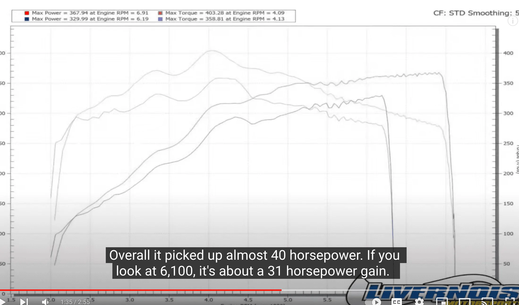

Here are some Dyno numbers by Livernois to show how going from 87 to e85 on just the factory 5.0 tune can be stronger (atleast in most of the rev range) than a 93 octane tune.
87 Octane Factory Tune
- 330 hp @ 6.19k, 358 lb/ft @ 4.13K
93 Octane Factory Tune
- 357 hp @ 6.56k , 374 lb/ft @ 4.18K
E85 Factory Tune
- 360 hp @ 5.14k, 414 lb/ft @ 3.97K
93 Livernois Tune
- 368 hp @ 6.91k, 403 lb/ft @ 4.03k
Notice how much lower peak power and torque are available with e85.
