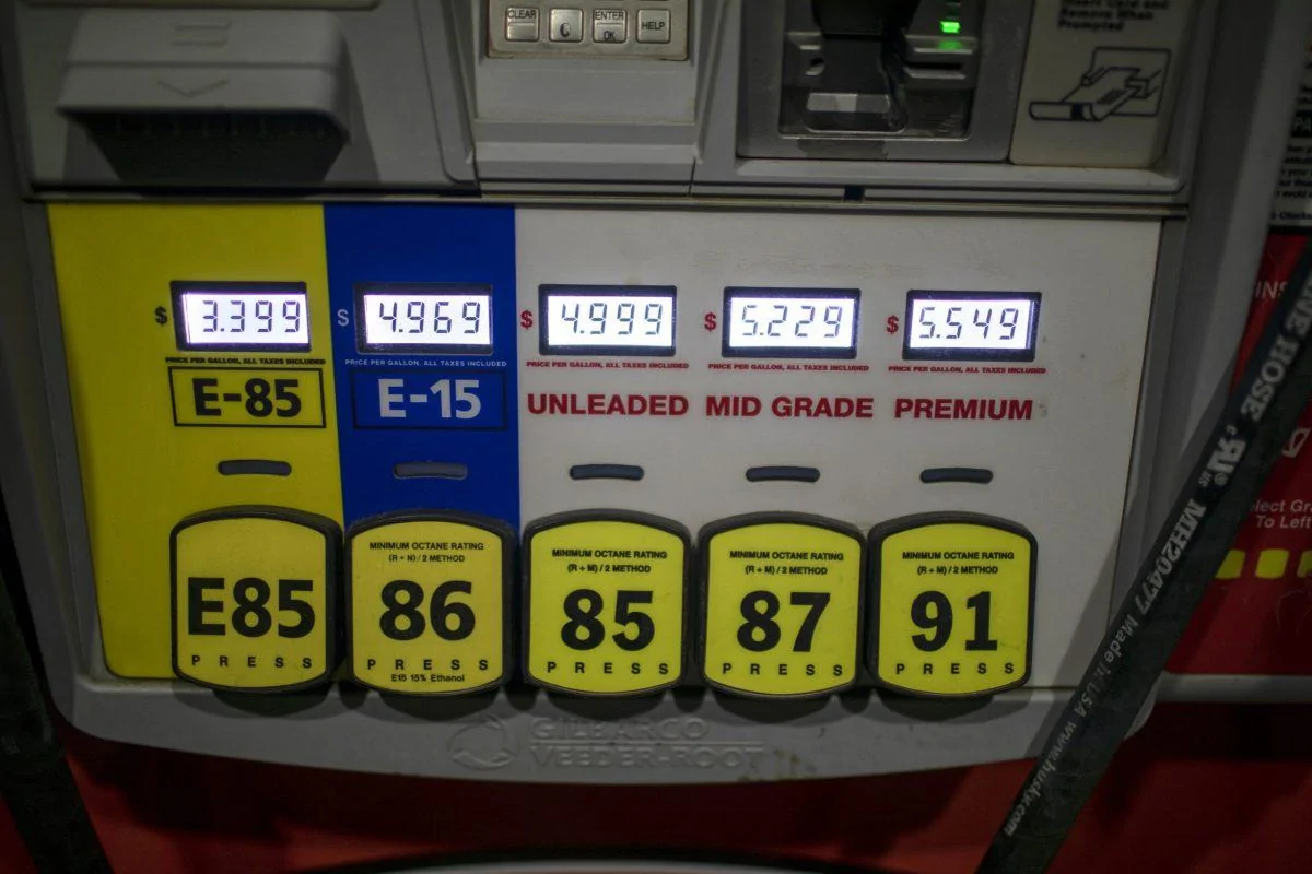

In FL we have e85 and 87, but I have always seen both e85 & 85 octane in other states. Typically, we don't have 91, we have 93 as our premium unleaded.
"E85 is not the same as 85 octane. E85 is 85% ethanol and used in flex fuel vehicles, the ones with the green leaf in their logo. At elevation you may find 85 octane which is used to help counter the thinner air."
Here's a photo of pump in Colorado (top) Florida (bottom)
Any even then, it varies in state. In South FL you're more likely to see the bottom pumps and in Central FL (Orlando) I've seen pumps resembling the top one, offering 91 as an option. Central FL is only about 85ft elevation vs 5ft or less in South FL.
