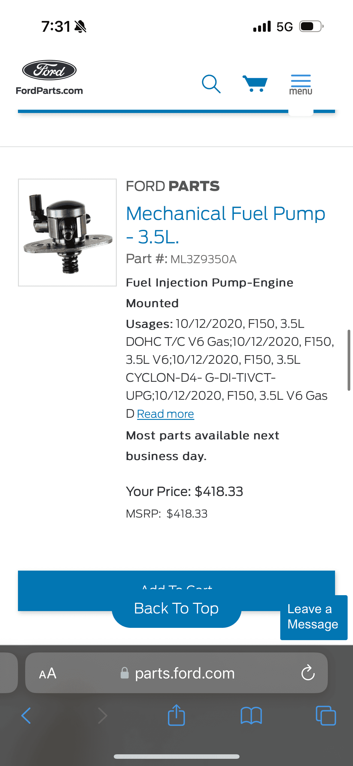

Ok, You guys got me into geek mode. I looked up the fuel pumps for the 5.0 vs. the 3.5. Both for the 2023 version.
Same part # given the same wheelbase, same tank. And surprisingly a damn good price too!!
The high pressure direct injection pumps are different though. Perhaps E-85 is interacting more with the high pressure side with the 5.0.

After looking at those mixing tables on the article I posted on the previous page…that’s a dynamic question. The mixing depends on load, coolant temp, and rpm all at once. I’d be guessing. I’d say it’s a combination of the fuel delivery and Ti-VCT system though :). If you are towing or under hard acceleration it seems the 5.0 goes to 90% direct injection with very little input from the port injectors, but at low loads the port injectors make up a large portion of the mixing.
