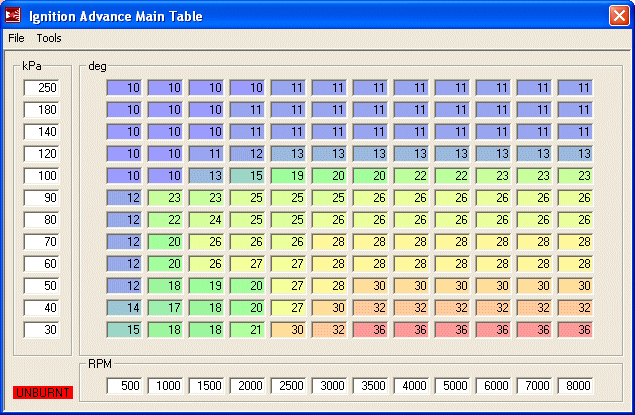

I assume that Ford is saying that the multiple timing tables do not contain parameters for octane ratings below 87?
Methinks the notion of 'multiple timing tables' may imply an over-simplification of what is in fact a very complex algorithm given the factors being 'juggled' that bear on the combustion process second-to-second (or fractions thereof):

But yeah, the 87 octane minimum recommendation certainly implies that there's some conditions where all of that juggling still can't ensure the targeted engine health and/or longevity with lower octane fuel. Those may be rare conditions but still fall outside of Ford's 'comfort zone' and they've got to anticipate worst-cases.
Remember that the PCM has no way of 'directly knowing' the octane of the fuel - it's just responding to various sensor inputs including 'knock sensors' ('octane-proxies', if you will).
They are described as "tables" by the various tuners using different tuning platforms.
And from what I understand, based on the various sensors, knock for example, the pcm will switch to the less/more aggressive timing table.
Here's an example of a timing advance table using HPTuner platform.
Ford F-150 87 octane fuel requirement ms1_spark_table_1
