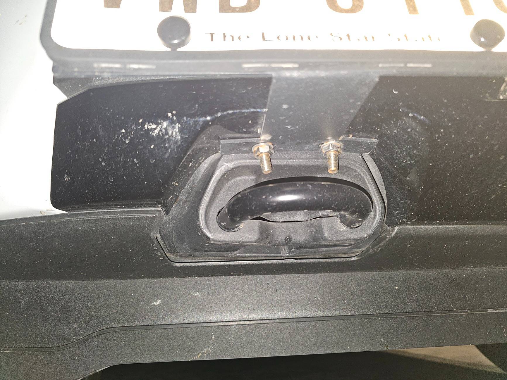

I bought this one off of Amazon, theres two holes behind the plastic bumper cover right above the tow hook. Once u lift a rubber flap u can see the holes in the bumper frame. From there the bottom bracket tightens up against the bumper above the tow hook. Alot of buyers want to mount it to the tow hook but not what its meant for. This is obviously on the passenger side as the radar or whatever is on the drivers side. I did have to modify the bracket by making the holes a bit bigger (more oval shaped than it aleady is) to have the bolts line up properly through the bumper. I have the 4 sensors, doesnt interfere with anything up to now.
Front License Plate Mount Holder... https://www.amazon.com/dp/B08ZMMGKHY?ref=ppx_pop_mob_ap_share
