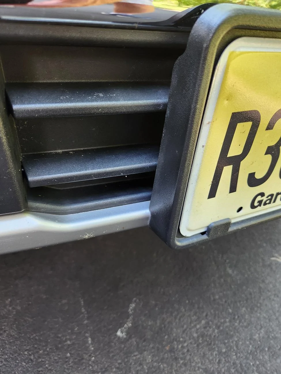

Hmm, @Big Dog Daddy 's 2021MY plate
Ford F-150 Front license plate BDD LICENSE PLATE
Seems to be mounted lower / 'covering' more of the intercooler opening than my 2022MY OE plate as it was delivered by Granger (notice on mine the plate clips are on the top, plate screws on the bottom ?) :unsure:
Ford F-150 Front license plate OE LICENSE PLATE
I'll offer that 2+ years in Texas heat with a fair amount of towing, I've not noticed any indications of untoward heating of anything, and the bracket is tight / quiet. Yep, gotta show a front plate in TX.
YMMV.

Ok, the mystery thickens. With all of this talk, I went out and took a closer look. The lower opening on my truck is completely blocked from airflow. The only openings in it are where the plate bracket tabs push through. There is no opening under the bumper in front of the air dam either. ?
The last photo is at the dealer moments after coming off the car carrier when it was delivered, completely blocked.
Ford F-150 Front license plate 20240713_154948
Ford F-150 Front license plate 20240713_154954
Ford F-150 Front license plate 20210419_124427

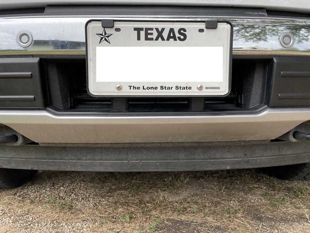

I just realized yours is a 5.0 with no OE intercooler vs my 3.5EB with OE intercooler, that and going for the slight 'aero-advantage' (grill openings hurt aerodynamics in theory) probably accounts for a lot of the difference in openings and plate mounting schemes.
Here's pics of mine showing the totally different mounting bracket and openings to both sides and below the plate
Ford F-150 Front license plate IMG_2400

Ah ha! I didn't realize that there was a difference there between engines. That certainly explains it. I can see now why people would want that open for airflow, but as you say it's been fine in the Texas heat ?

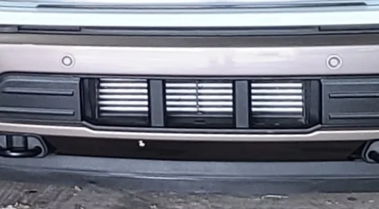

I also removed the louvers from in front of the intercooler. (@Big Dog Daddy, you now know that you don't have a hole there, nor the louvers)
Ford F-150 Front license plate 20240714_132106
By the way, removing the louvers and license plate doesn't do squat for lowering IAT's on the Powerboost if you aren't on the interstate or you aren't in either Sport mode or Tow Haul, because when the Ecoboost/ICE is in EV mode the IAT's skyrocket. There's no airflow through the intake, so the intercooler and the intake just sit and heat soak.
Still, I have no intention of having the louvers or the plate blocking that heat exchanger.

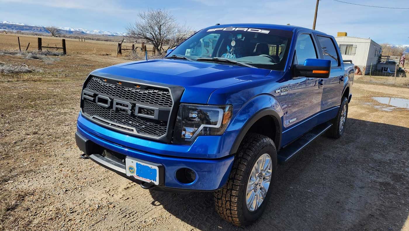

I'd like to agree, but Ford did move the license plate to the left on the Gen12 3.5 Ecoboost F150. Exactly for the obvious reason.
Ford F-150 Front license plate 20230331-PM-1
However, as technology has been added to the vehicle, there's now sensors that reside behind the plastic facia in the bumper. Ford can't mount a piece of tin in front of the multiple sensors and options on these trucks.
Again, on the Powerboost I don't think it's that much of difference. But a 3.5 Ecoboost absolutely could prosper with removing the plate from in front of the intercooler. My opinion anyway.
