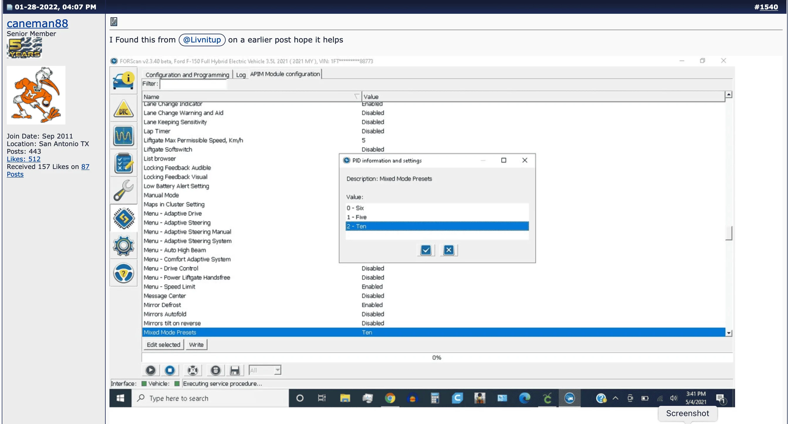

Changes that I made:
Digital gauge readout. I like this for the coolant, not so much for the transmission. Why this setting isn't OEM is beyond me.
Double honk disable. The honking was just annoying.
Lane change blink number. The default 3 wasn't enough for my liking. I upped this to 6.
Heated steering wheel temperature. I like my wheel heated so I maxed this out at 39°C.
Oil life % in SYNC settings. Why not?
Glare-free headlights. Glare-free is working, but I can't see any better lighting over the auto high beams. It's a little tough to see the lights adjust themselves to oncoming traffic. It is different to see the lights ramp up to bright vs just BAM high beams on. I haven't had any oncoming traffic flash me. In case you're wondering, you can manually select low or high beams still. I'd like to view the glare-free lighting from the the oncoming drivers perspective.

As best I understand it, the Unreal engine mod activates different graphics software that improves the crispness and clarity of the screen. You need the latest Sync version for it to work. The FDRS thread discusses this.
And for DRL brightness, I used 55 which should give 85% brightness. Some people have noted flickering with higher amounts:
