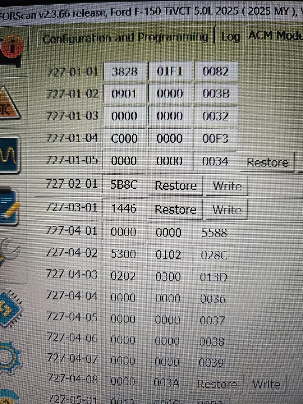

If I want to turn off Enhanced Engine sound
this gets confusing,what number do I change here? (2025,F150,5.0)
