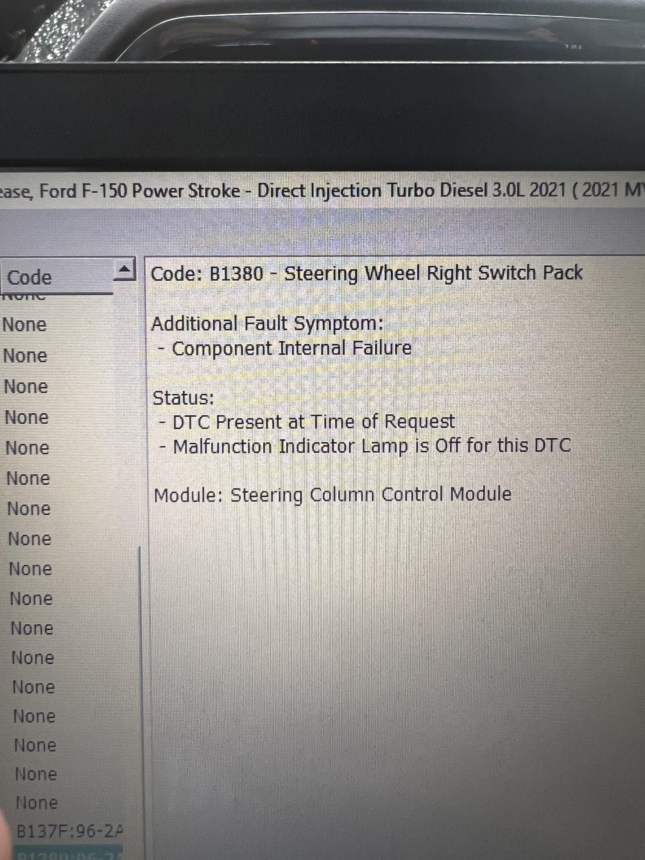

I followed the guide on another page to enable glare free lighting but kept getting checksum errors when changing certain module values and them DTC codes for the SCCM module. What process did you use for the glare free lighting?
I followed Robb’s directions here.
Keep in mind the last 4 lines in bold in his post there are options based on how your truck is configured. In other words, if your truck is a short bed with no scales or CCD, then you do the first line, not any of the others.
The checksum error when writing values in Forscan are normal. You can ignore those.
However, the DTC’s are not to be ignored, especially that one. To me that means your dynamic bending lights are malfunctioning. You probably have one of the value changes wrong. I would start with the SCCM. Make positively sure it reads like this: 724-04-01 xxx4 xxxx
Make sure you backup all your modules BEFORE you make any changes to them.
It that doesn’t work, I would post in the glare free headlight thread with photos of your values you changed for each module.

I will try the changes again and save a picture of each. I triple checked everything yesterday and could not find anything wrong unless I am misunderstanding something. I did save the as-builts before modifying anything and put everything back to factory when the DTC codes would not clear.
Did the DTC’s clear and stay cleared after you put them back to stock values?

Yes they did. I am wondering if the Diesel engine has some different options causing the issue. I need to look through the spreadsheets and see if something is obviously different with the options on my build.
