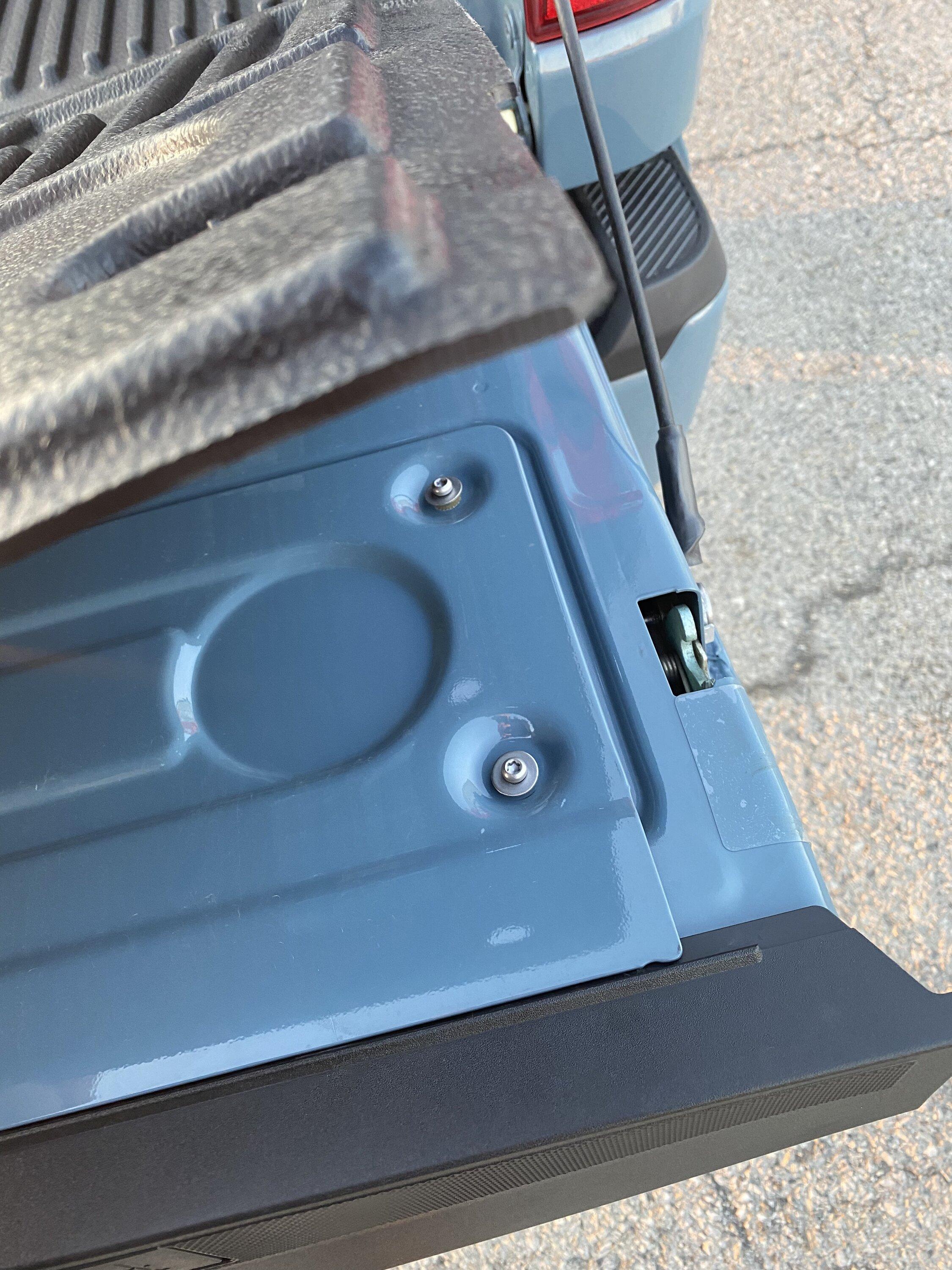

Any ideas what to do here? My dealer was adamant Ford does not provide fasteners for the tailgate cover and you are to use to ones in the metal panel on tailgate. Problem is there was only 6 screws on my truck from the factory and there are 8 holes on the cover. Bigger washers? They pop right through, almost lost it in the highway today. Pretty crappy setup for an OEM supplied cover imo.
Anyone know a part # for these screws? If I can buy two more online and just get bigger washers at Home Depot it should fix it.

Negative, pulled them out by hand after they popped through the cover. I think the dealer was just lying to me because they didn’t have the pack of the correct screws and washers. My dads F-250 has black ones with fat washers that Ford supplied. I don’t think there is any way Ford is sending these accessories out with no way to fasten them.

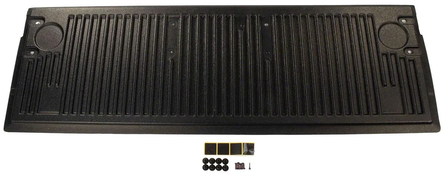

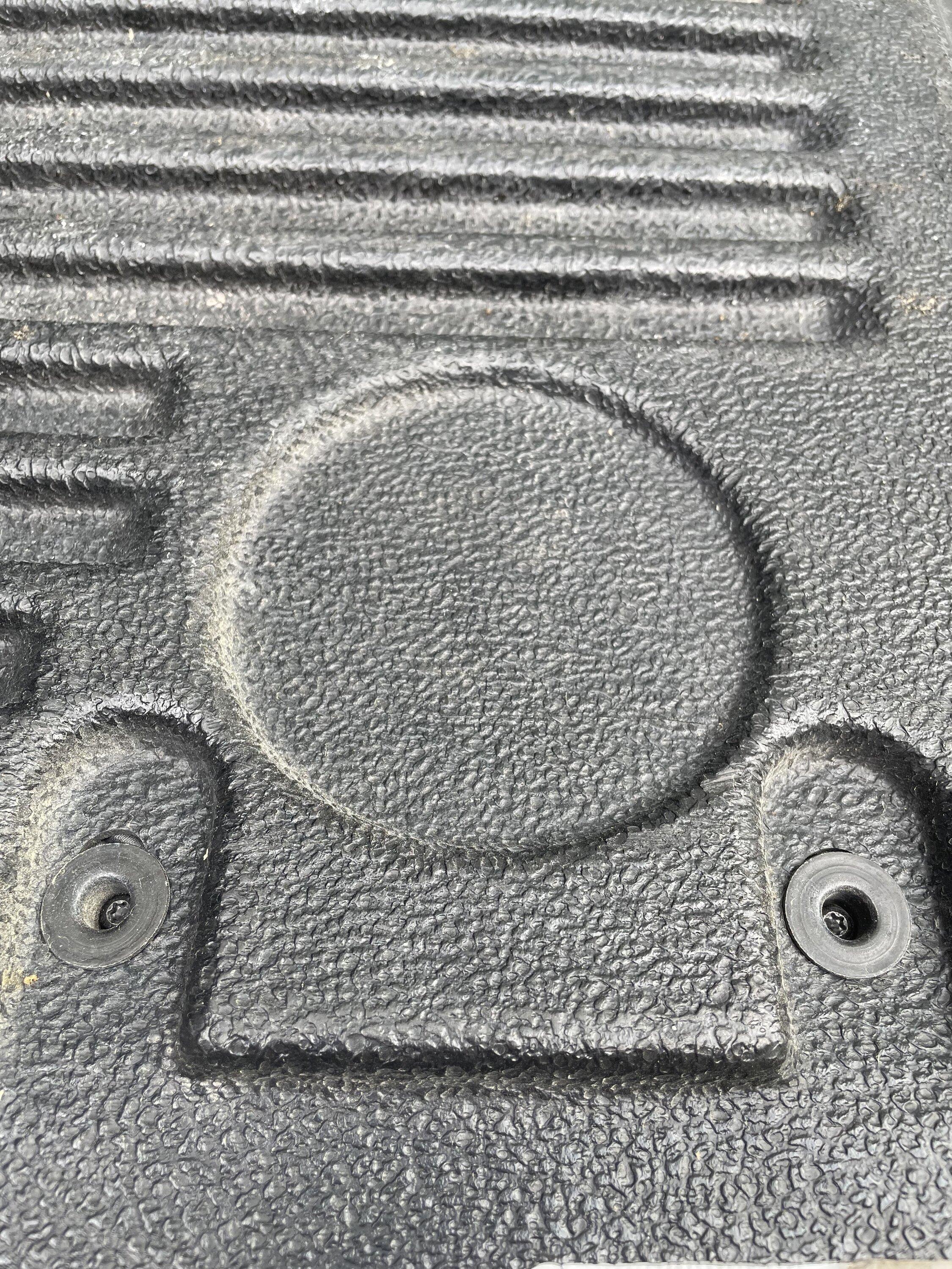

The last one I purchased came with new hardware. Remove the eight screws and replace with deep concave washers with a lip to hold it tight. From what I remember the screw bag did have a part number and directions on it so you can probably order them. Here is a youtube video that may help a bit.

truthfully, i would just go to a Fastenal near you. Found out your thread pattern and just get replacement screws/washers. they should have a huge assortment. worst case is try a hardware store or HD/Lowes
i mean, you probably just need bigger washers but as the other guy said, i'd look for some black hardware over the shiny stuff.
yeah, the guy with pics above me is exactly what you're missing. the insert holds the cover down but the screw is recessed.

As others have said, it should have came with new hardware. Google doesn't return much on these numbers. I would have dealer order it again and return the other. Search for P/N: ML3Z9900038C on parts.ford.com and it doesn't show a separate number for the hardware. The picture on the Ford Accessories page shows the hardware also: Ford Accessories.
