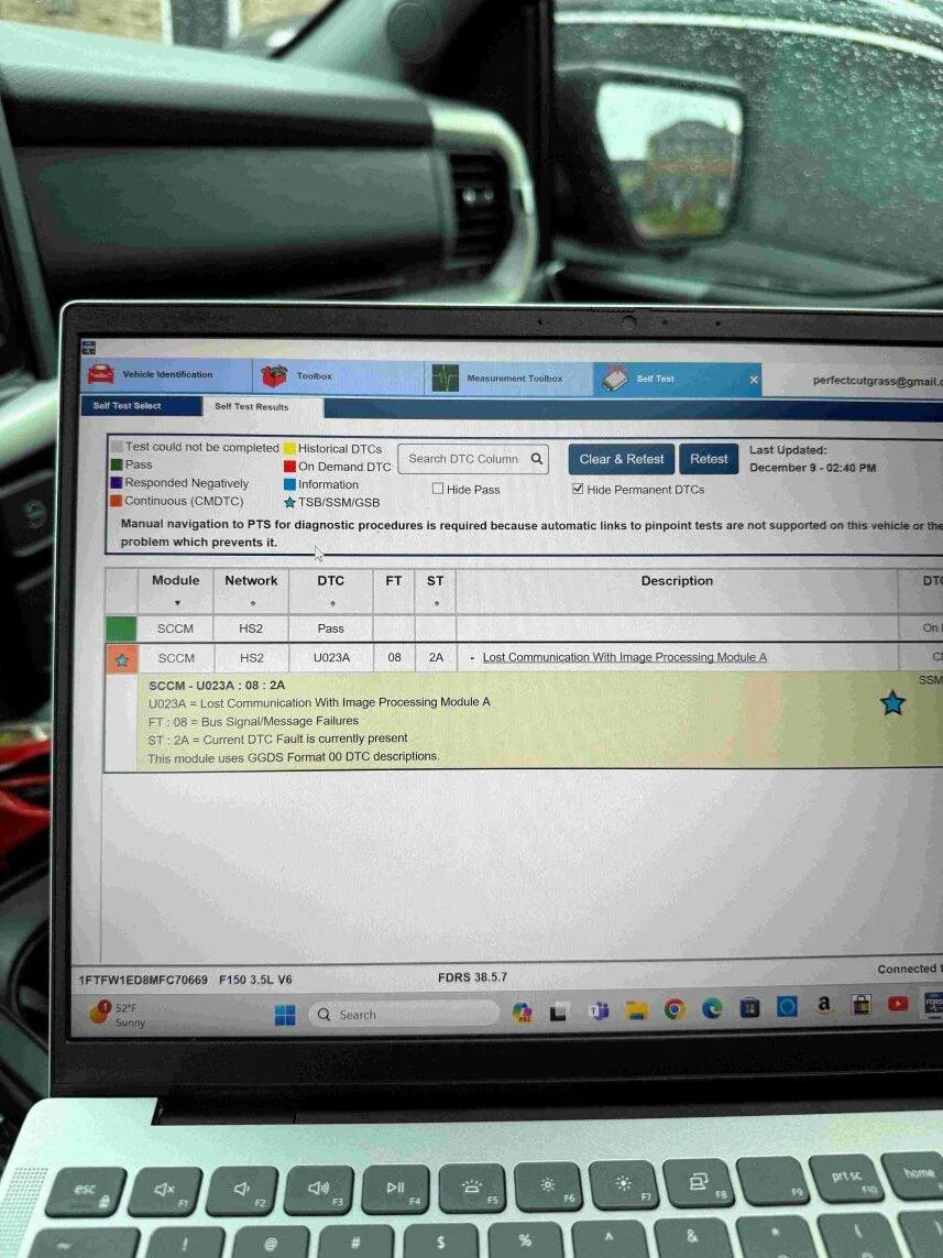

If anyone has some insite would be awesome. I know i took off the active air dam. So the one is a given. Does it have anything to do with the other errors?
i know im not fully up to date as my revision is only at 915
Ford F-150 FDRS Problem IMG_3
Ford F-150 FDRS Problem IMG_2
Ford F-150 FDRS Problem IMG_4
Ford F-150 FDRS Problem IMG_5

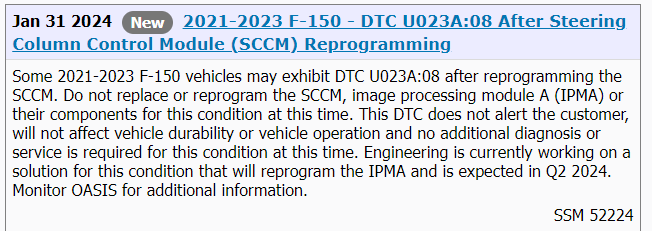

This looks like it might apply:
SSM 52078 2021-2023 F-150 - DTC U023A:08 After Steering Column Control Module (SCCM) Reprogramming
Some 2021-2023 F-150 vehicles may exhibit DTC U023A:08 after reprogramming the SCCM. Do not replace or reprogram the SCCM, image processing module A (IPMA) or their components for this condition at this time. This DTC does not alert the customer, will not affect vehicle durability and no additional diagnosis or service is required for this condition at this time. Engineering is currently working on a solution for this condition that will reprogram the IPMA and is expected in late December 2023. Monitor OASIS for additional information.

Clear and retest and see if they are still there.
Thanks… I’ll have to wait I see.
I’ve done that several times. Comes back soon as you retest.
Just wondering where you found that info you sent above about the sccm reprogramming? just trying to keep a look out for a fix whe they come out with one. thanks

I have the same DTC after updating the SCCM module today. I also updated to the latest IPMA earlier in the day so it looks like we are still waiting for a fix.

Same here. Just did all the updates yesterday to get myself current since OTA was "stuck" (again). Doesn't seem to affect the ability to do BlueCruise or anything else that I can detect.
