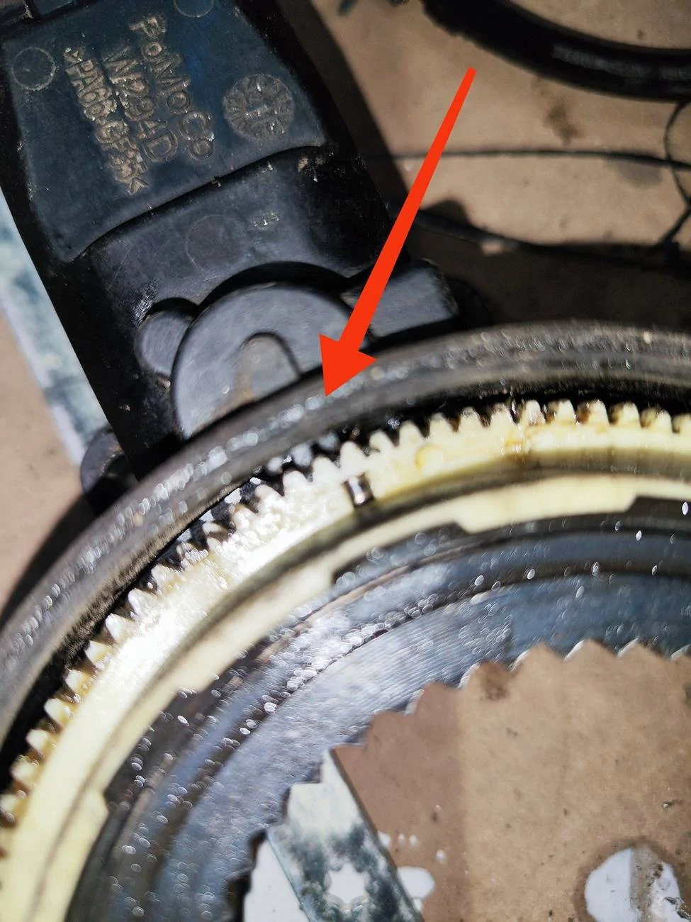

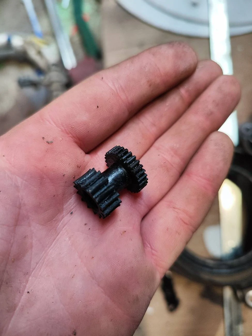

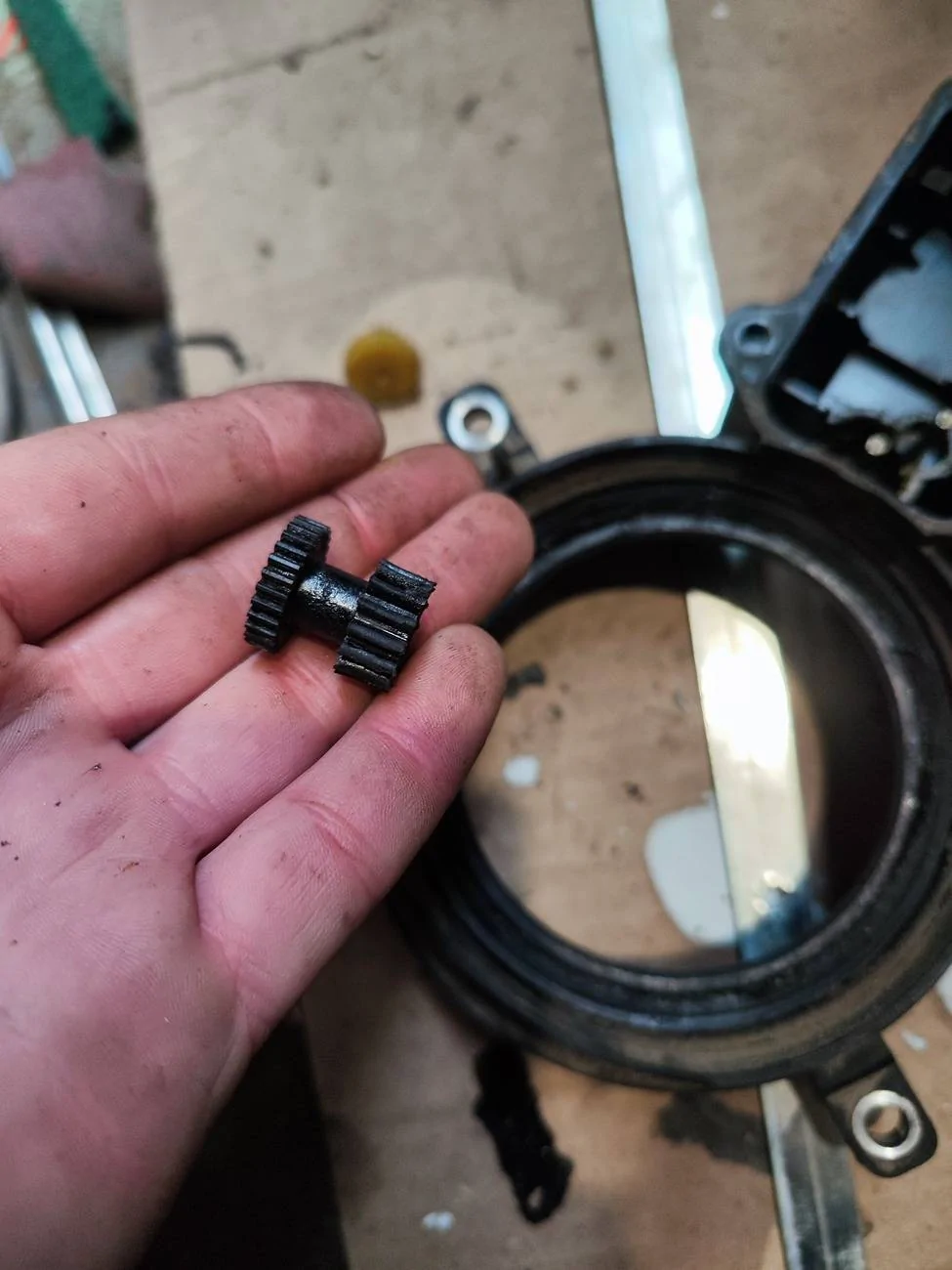

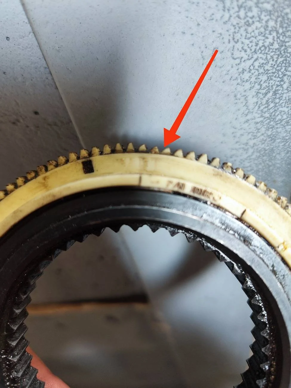

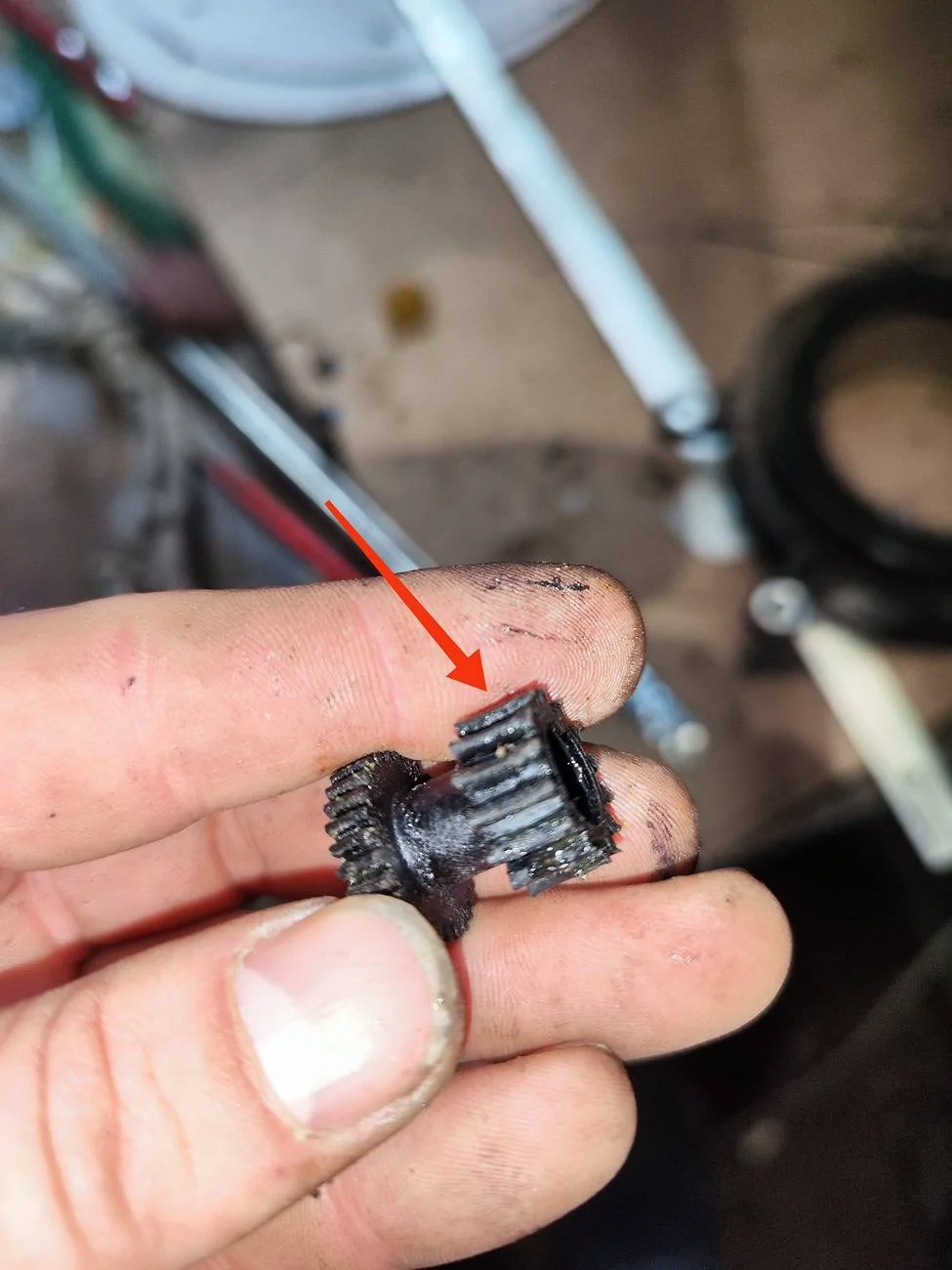

Hi guys, maybe someone will be interested. I disassembled my electric hub. The problem is the worn teeth on the plastic gears.

After replacing the problematic hub with a new one, I connected the old one to the car to understand its operation. When starting the car, it turns them on and off regardless of the mode, that is, it conditionally tests
