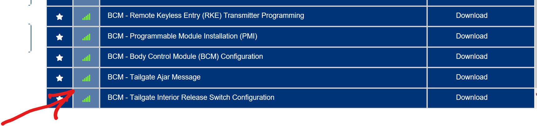

JJLikesIt
JJ
Aug 18, 2021
70
TORONTO
2024 Lariat 4x4 3.5L
BlueLine
Anyone also have the same issue with the dash release?!? Am I the only one???
