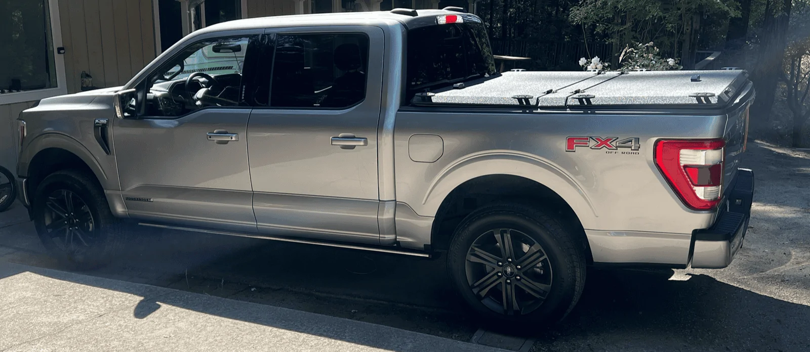

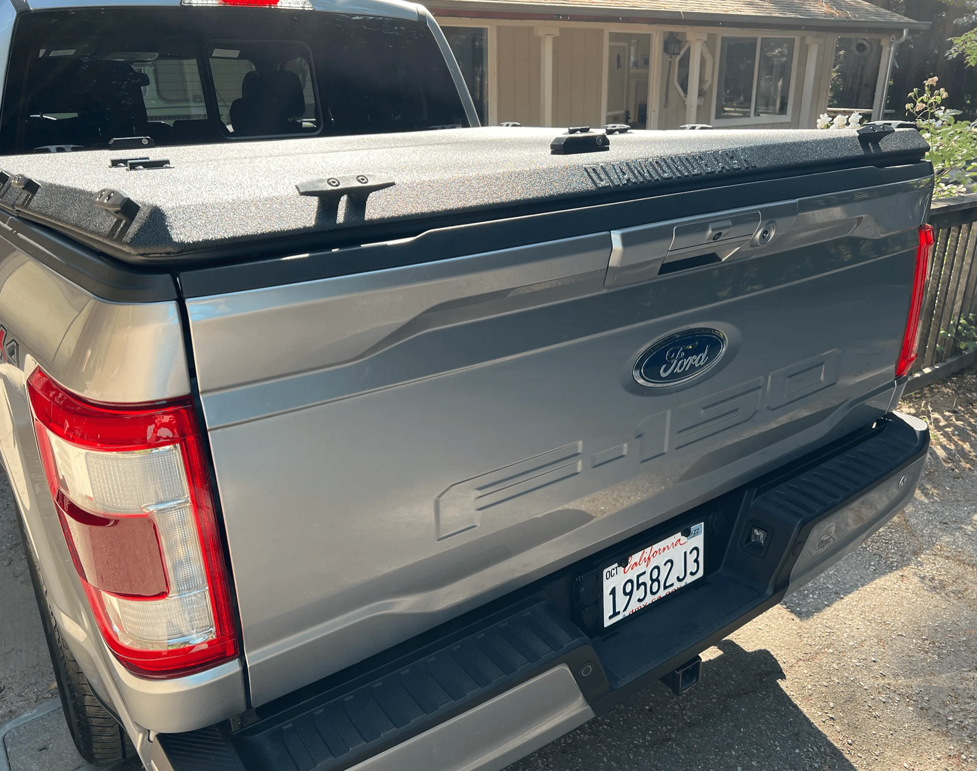

Yesterday I took the truck into a dealership and after 1/2 day they said they are doing a software update and that’s going to fix it. Today after no call all morning. I call them and they said bad news. We can’t fix your problem because……. drum-roll, you have installed a 3rd Party truck bed cover. I am very confused because almost everyone who buys a truck gets a truck bed cover or a camper shell to protect/lock your stuff not to mention stuff flying out when you driver around town.
Even on Ford.com you can buy/order a truck with a truck bed cover ?

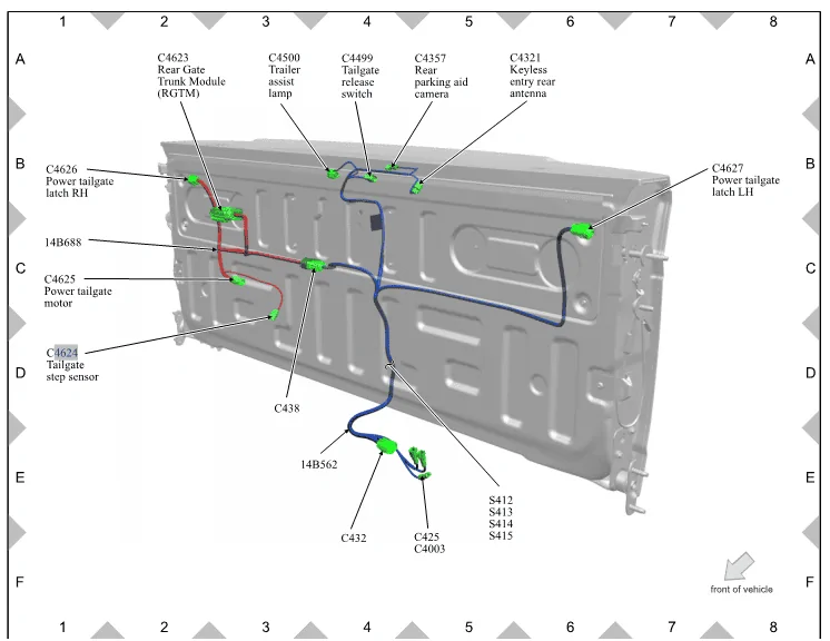

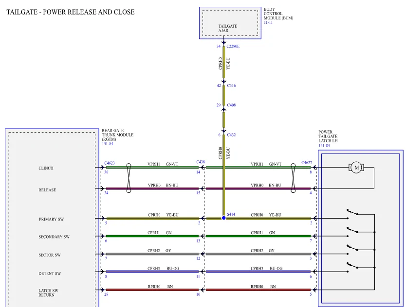

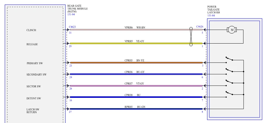

I asked for the part number Control Unit - Ford (MU5Z-14B291-U) that's what they think is causing the problem. See attached photos. I opened the tailgate (all 13 t30 screws) to look inside. I was hoping to find two wires like I have seen in many online videos with other F150 having the same problem. No wires. They have two L-R top actuators for the locks. Two L-R bottom actuators for moving the power tailgate up and down. There's a sensor under the tailgate step, and then there's a control unit.
So I have part number but what if I get that new module plug it in and it needs to be programed to function or worse something else is broken.
Again it just stopped working out of the blue I didn't do anything special. The cover I have is also aluminum in fairly light so maybe 30 pounds of weight on that back panel or less and most of the support is on the two sides of the truck bed and not all on the tailgate. I put the cover on right when I bought the truck last October 21 and I've had zero problems. It didn't even rub or make any funny noises opening and closing so it didn't seem like it was putting any pressure at all onto the tailgate. never had trouble closing because of the truck bed cover.
What should I do ? what if I am not even buying the right part? Does anyone find it odd that they think the control unit will fix the problem. How would even standing on the tailgate cause a faulty control unit.
I am really saddened that a. it was not covered under warranty and b. that I am left with trying to diagnose a problem on a brand new F150. Are we all to think that truck bed covers break control units?
The worse part of this is the design. Ford gave us no way to get out of this problem. If the power tailgate fails and I could at least use it the good old fashion way manually at least we have a workaround not $1000 a month broken unit. sad face! We should be able to pull a cable or un attach something to get it working.
