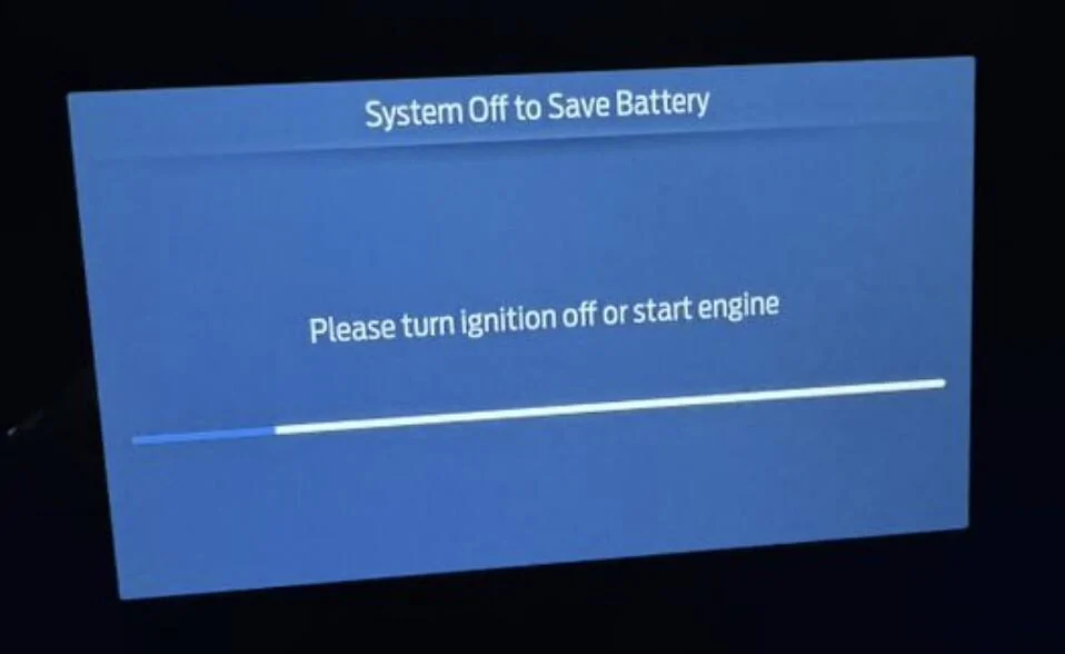

Technically the GWM is done... the USB loaded, but the truck is going into power save mode with the ignition off, so it cannot complete the update, and the BCM cannot be updated by me. Security login required.
Definitely a usual sign your battery is on last legs. Mine just randomly failed last December and it wasn't even cold out. ?‍♂

Definitely not the 12v battery.
Went back to AutoZone and pulled the battery from the truck to test.
It's perfect. Sitting at 98% SOC, yet my truck keeps going into power save mode and reporting low SOC.
Could it be my hybrid battery is having issues?

Still scratching my head on this one.
Diagnostics say there's nothing wrong with the charging system.
Bench test of the battery outside the truck shows it's at 98% SOC and still fully capable of putting out 800+ CCA of juice on demand.
Stick it in the truck and I get this....
