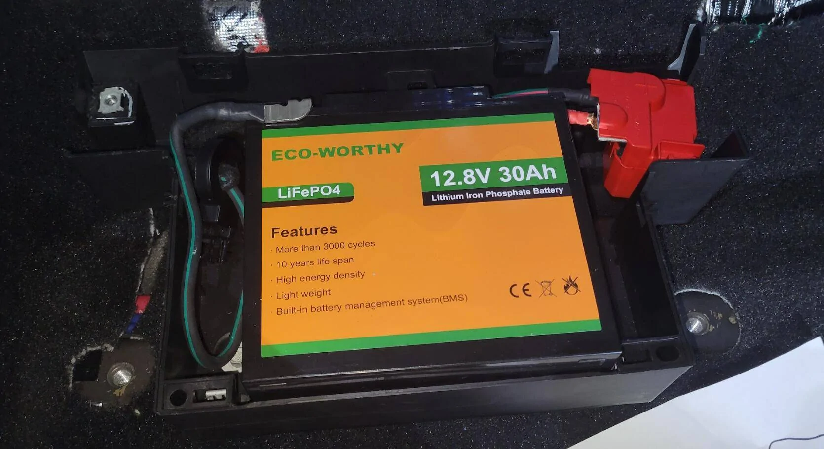

As long as the charger can charge AGM, that's all you need and even then you really don't 'need' that. As for battery size, I put an LFP in mine and it required hacking up the battery box a little bit but here's the end result.

I figured I was stuck with AGM unless I wanted to spend well over $100. Nice find on that one!
Have a link to a thread for any specific changes you made to help fit that 30ah battery?

I bought another battery tray off ebay for $50 delivered as it was unknown territory cutting into the tray itself to make that fit. LFP battery life can degrade quickly if charged below freezing which is why I've not really suggested people to go LFP aux route due to the varied winter conditions seen across the US. That battery is touching the lid -- its fit is tight, but the lid closes / snaps in. if it was 1/8th inch taller it wouldn't close.
You could use an H8 if you pull the battery isolator out of the battery tray and just leave it chilling next to the battery under hood. The wires are sufficiently stiff to keep it in-place. Wouldn't be hard to secure it if desired -- I didn't try. The LFP affords me a 'free' 25ah worth of reserve capacity before the under hood AGM starts to get consumed which is quite considerable. Can't speak to the long-term effects of this arrangement though. Keeping the AGM at 100% is supposed to have long-term negative effects but I'm not sure when they'll show up. It's only used for starting the ICE while moving in hybrid mode so even if it degrades to 70% health it still might not show up.
