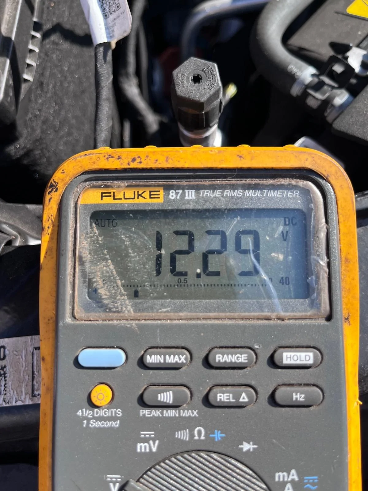

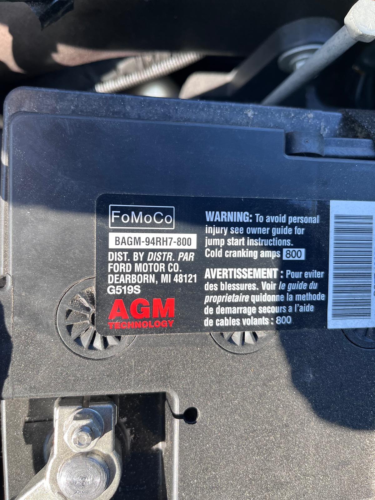

I have no idea about SOC settings, but I have the original battery in my 22 job 2 PB and this is the resting voltage first thing in the morning.

And remember if I measured it correctly it’s a Fluke ?
The only issue with your method is the open hood required, as well as the potential approach.
Not saying you did anything to wake it up, but the battery will take a ~.3V hit the second it opens its eyes even a crack.
Looks like you're sitting right at 70%soc. Mine after approaching the truck a few times, opening the doors a few times, and then the hood was at 12.3 this morning as well. I've just got some extra capacity with my H8 than you have with your H7. Also, an H7 should be what Ford put in these trucks as a minimum!

I didn’t take the fob with me and used the keypad to unlock but I did notice my opening doors and using the keypad was invading its space lol. The voltage climbed from 12.27 to 12.29 while I had the leads on. It settled at 12.29 after 10 Mississippi’s. Now if your blue tooth device is not powered by the vehicle then I agree your method is more accurate. If the truck is aware of your presence in any way it spoils the measurement a bit. Splitting hairs but it does.
