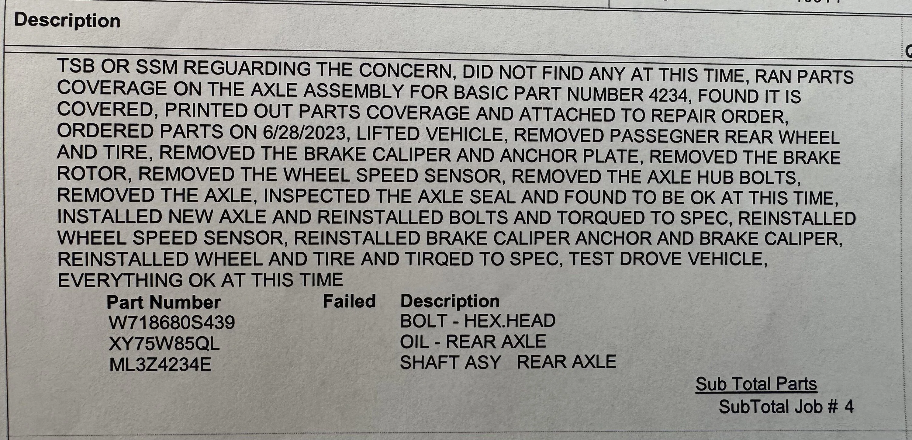

I can confirm that I have the Max Trailer Tow Package. Today I picked up my truck, I have attached the explanation.

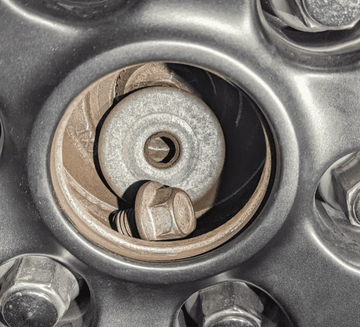

Now I'm hearing a clanking sound from the left rear wheel at slow speed. Started last week, but I've been on a road trip and haven't been able to check it. I'm back now and need to pull the rear wheels and see if I'm another victim. ? PB MT 15k miles
Well that did it. I had an old plastic work badge that is a little more flexible than a credit card and it worked as you described. I only checked the driver's side. I'll check the passenger tomorrow. I'm officially on the list. My dealer's website says next available appt is end of December. I'll call them tomorrow and see what they can do. Thank you!
First pic is what it looked like when I got the cap removed.

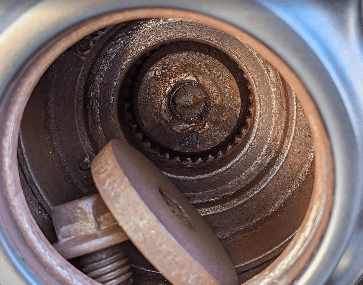

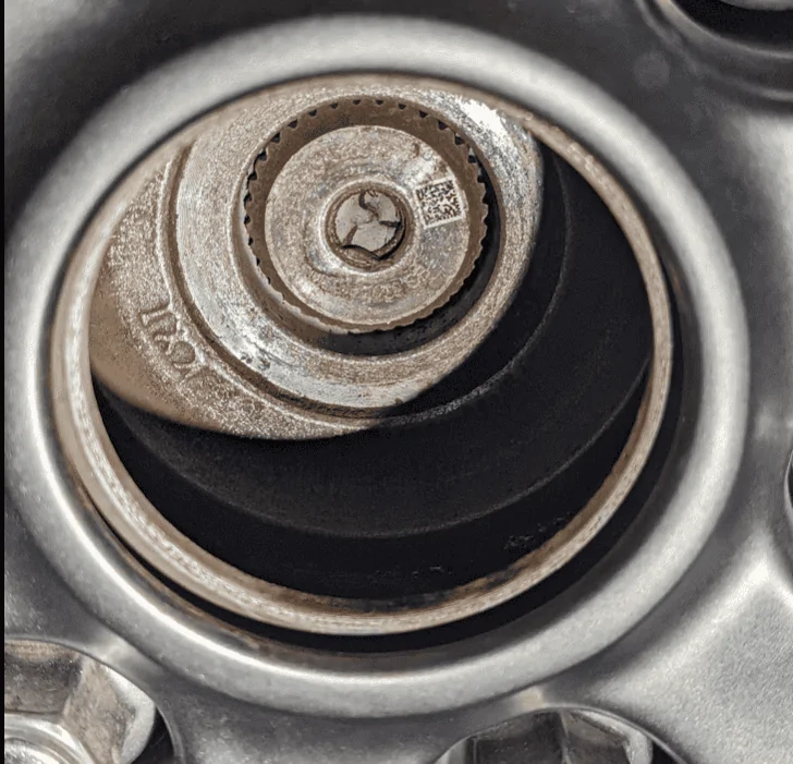

Well, 10 months later, I'm just under 24k miles, and noticed a little clanking again only because I opened the windows due to it being a bit cooler finally. Yup, this time it is the passenger side. Called dealer, earliest appointment is Nov 21. They will also order the parts for the open recalls and have a loaner ready.

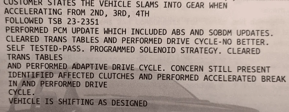

Also told them that I was getting some hard shifts between 1st and 4th during half throttle from stops. This is what they did.
