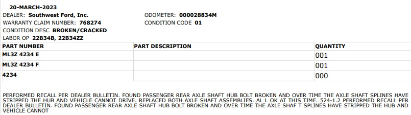

Recently purchased a 21 Platinum Powerboost with Max tow with 30K miles. While digging thru some other issues, I found this:
Ford F-150 F150 Powerboost Axle bolt sheared off 1685559890762
Since this repair has just been done, does anyone know if the new parts are improved and certain to prevent any future failures? If not, are there any known aftermarket repairs that get this resolved (different bolts for example)?
Though they should only use any new parts, they will absolutely most likely use whatever is on the shelf until depleted. Based on the repeat failures people are having, this is most likely the case.

So I've decided to go the same route as @CashforDumpsterFire posted on the F150forum.com. I just ordered these https://arp-bolts.com/kits/arpkit-de...?RecordID=3565 and will install when they arrive.
I've had the truck for a month and both axles were replaced by the dealer in March because of breakage (right before I took delivery). I'm just not willing to wait for a fix from Ford or deal with the dealership if/when they fail again.
My question is on the removal of the factory bolts. I'm worried that if the bolts have been over torqued by the dealer, removing them may cause one/both to yield/break. Anyone have any experience using heat or other methods to help safely remove them?
If the bolts aren't the real source of the failure, using non-factory bolts might be an issue warranty-wise if there is an axle failure.
I'd say your concern is unfounded, unless they have the carwash kid doing axles.
