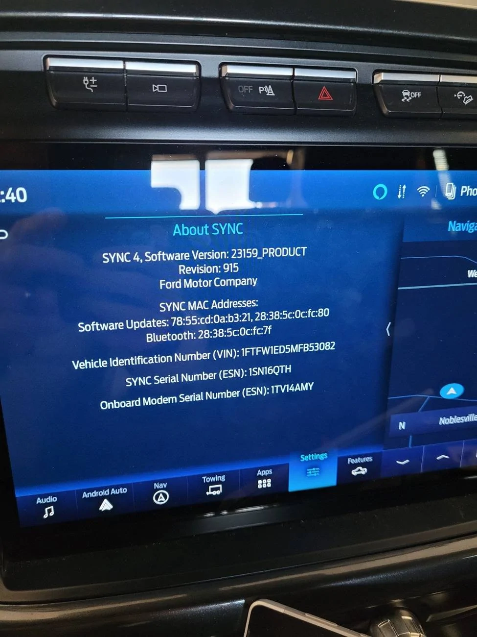

Started on a new to me 2021 Powerboost in August 2024 with FDRS, tried following all the instructions to get my APIM updated (USB, ethernet, etc), ended up following the "just leave the flash drive in the port for a few weeks" wisdom, pulled it out after a month of no action before a 2 week vacation roadtrip, put it back in with no confidence after, and finally broke the digital dam about a week ago, completely out of the blue.
Bought another 2-day FDRS license and got it up to 23159 version 915. Only thing remaining in the queue is the steering column control update - anybody familiar with that one? I'd really like to be finished with this monotonous journey...
