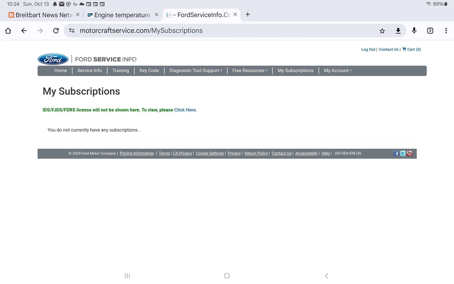

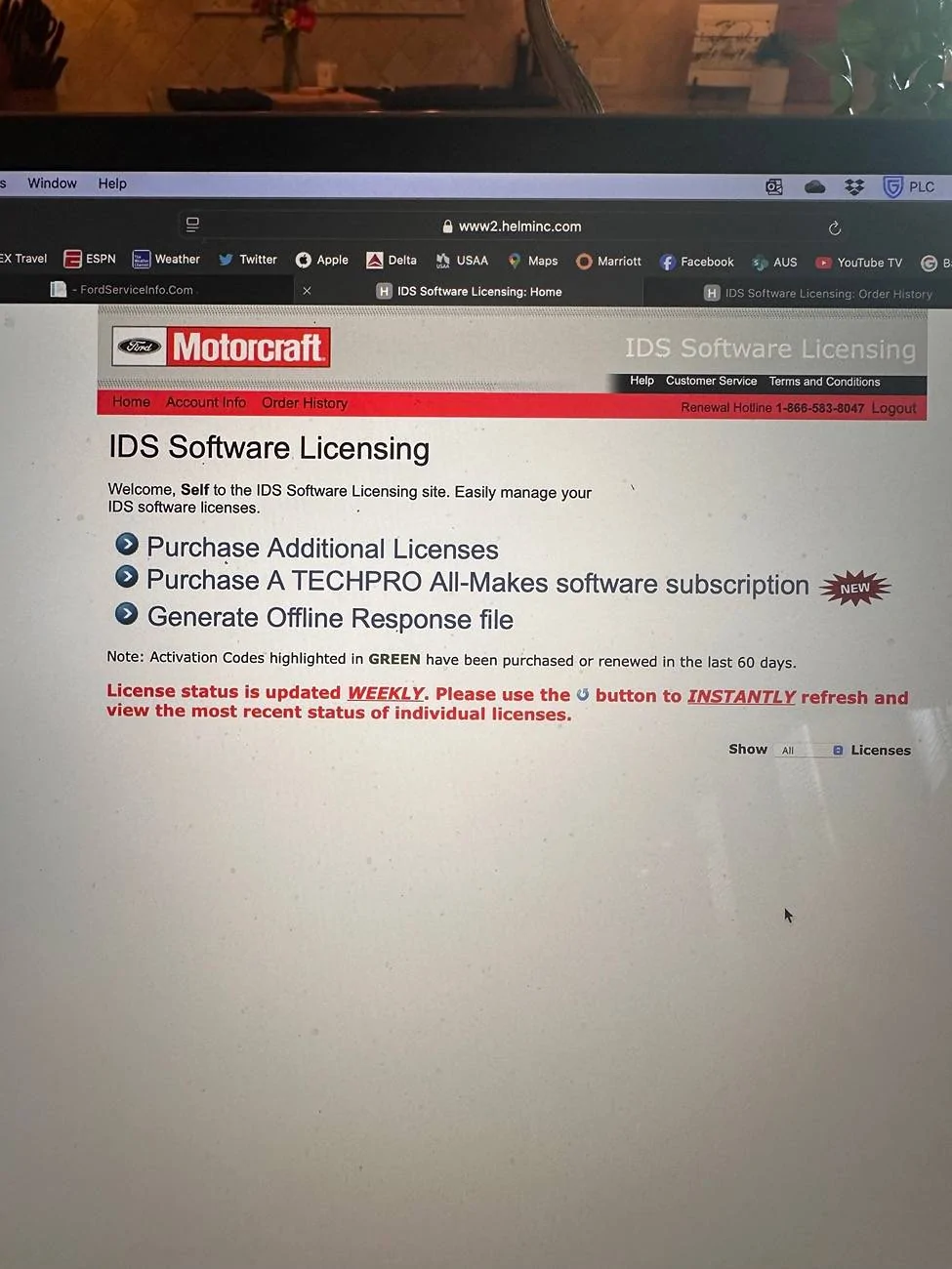

Your subscriptions will show up here.
Got it. Thanks. My screen is the same as yours, showing no subscriptions. So perhaps my order just hasn't processed.

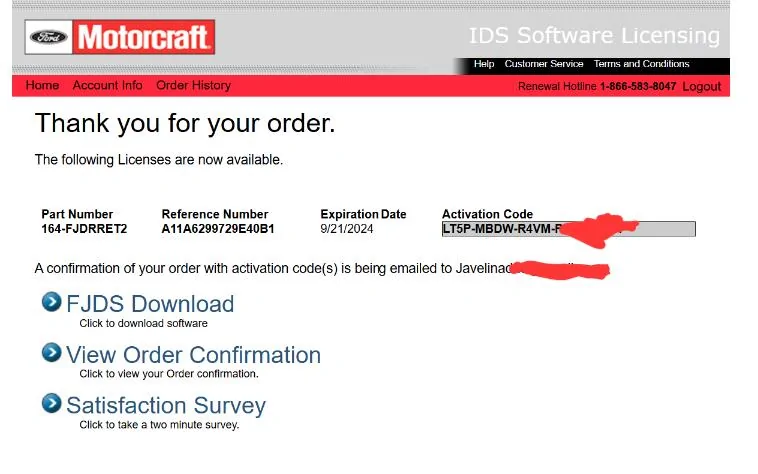

I definitely get confirmation on the screen that the credit card transaction succeeded and then the license key is presented at that time.
So something didn't process successfully, from what it sounds like you describe
Here is a screenshot from a previous confirmation result
