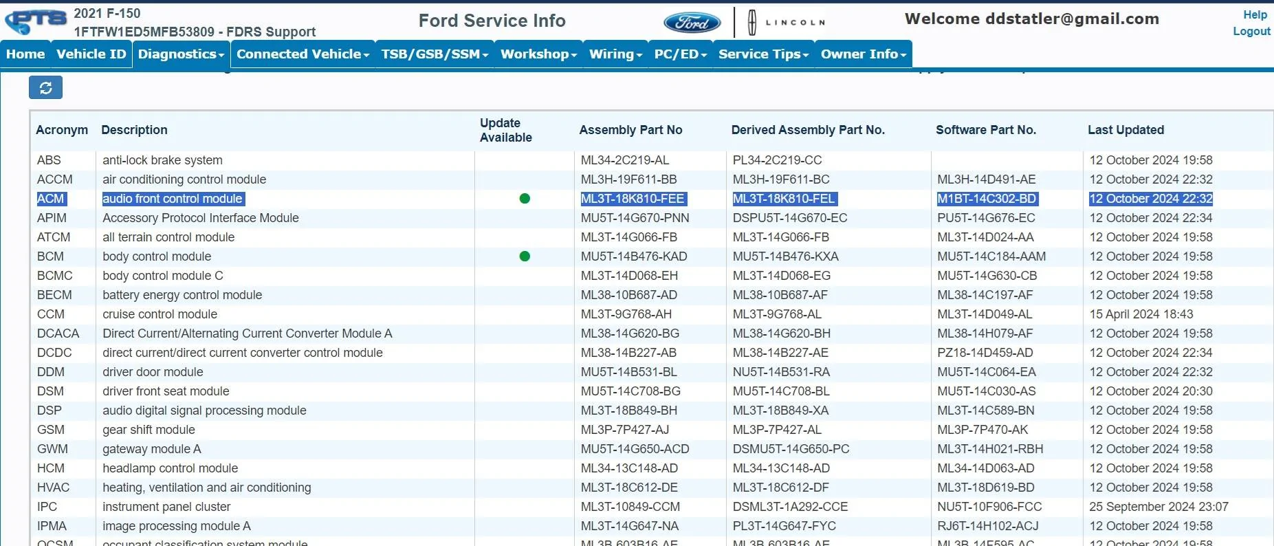

Anyone else having a problem with updating the audio front control module in FDRS. It looks like mine is in the installed but not clearing loop.
Over the summer I updated my acm the software took but it didn't clear the list either.

Alright, thanks for the reply. I'll let it go and and not worry about it. Just wanted to make sure it wasn't a new bug..

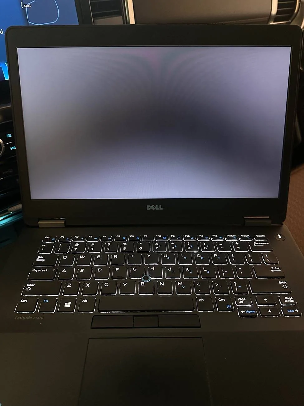

Official I am concerned post. I’m a Mac guy so don’t know Windows PCs anymore. I’m in the middle of the IPMA module update. I set the PC to never sleep. Everything has been going great. Came back to check on the truck and screen is blank. Can’t wake it up. Afraid to toggle power button. It was in the middle of downloading blocks.
The Mingoose left side is green. Right side flashes red.
Dtaving off panic here. Any thoughts or guidance?
