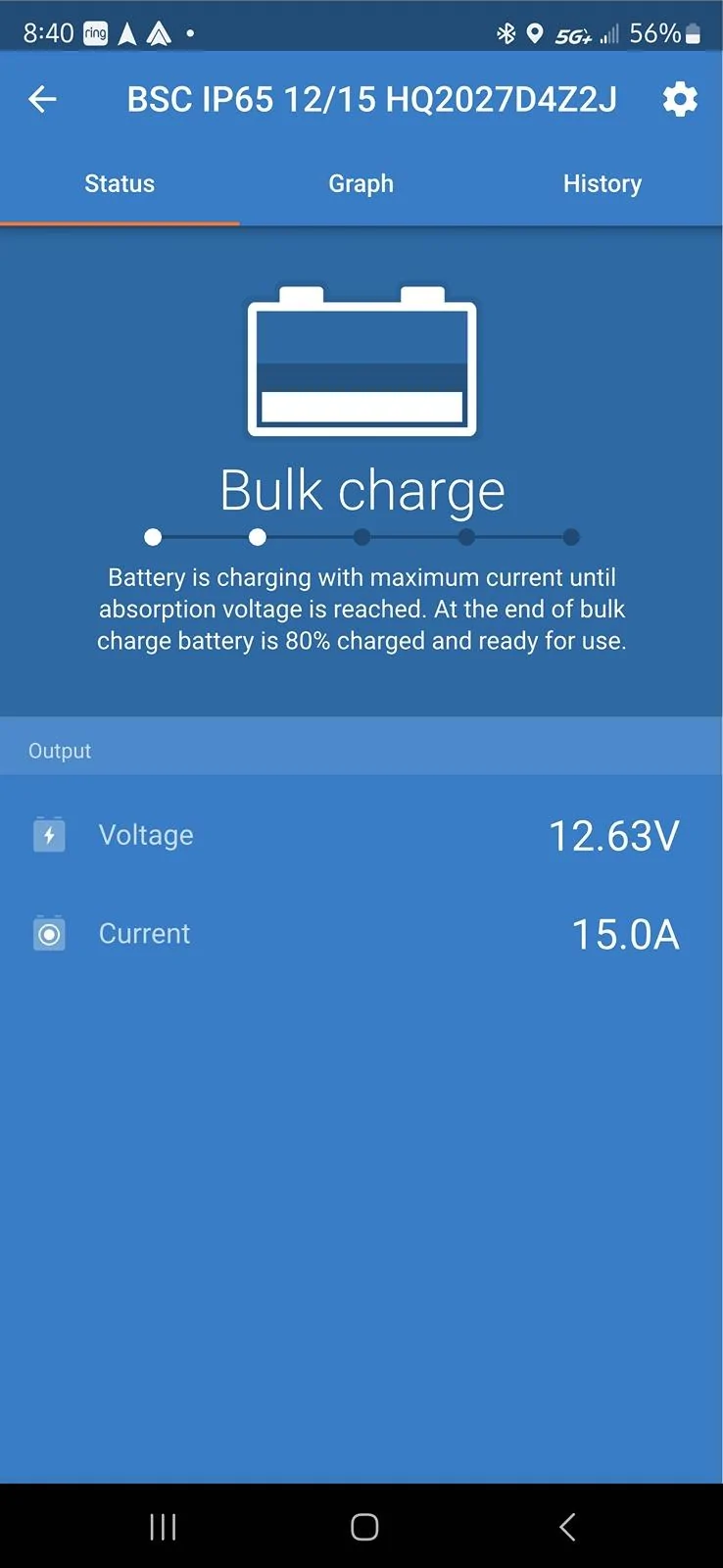

2022 Powerboost
Something I noticed while updating.
The Battery voltage at the OBD reads 12.3, but the voltage at the Battery is 12.6.
I'm not surprised due to various loads and voltage drop with the thin wires, but does this come into play with the 80% SOC charging parameters our trucks are set at?
Meaning 80% is actually 100% due to the voltage reading differently?

You will want to make sure you are doing updates using a power supply and not on battery alone. Some updates will really tax the battery, and you don't want voltage to drop to low.

Yup, Im using the Victron brand charger.
(I'm in the battery industry, and these are the most accurate and best chargers available for general-purpose recharging)

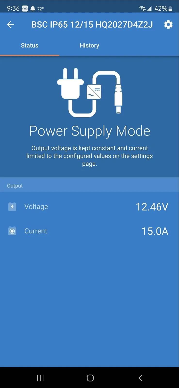

Maybe for charging, but if your Victron can’t be locked into power supply mode, it’s not the best choice for programming. Chargers—Victron included—keep amps constant and allow voltage to float. This is exactly the opposite of what you want to do when programming.
