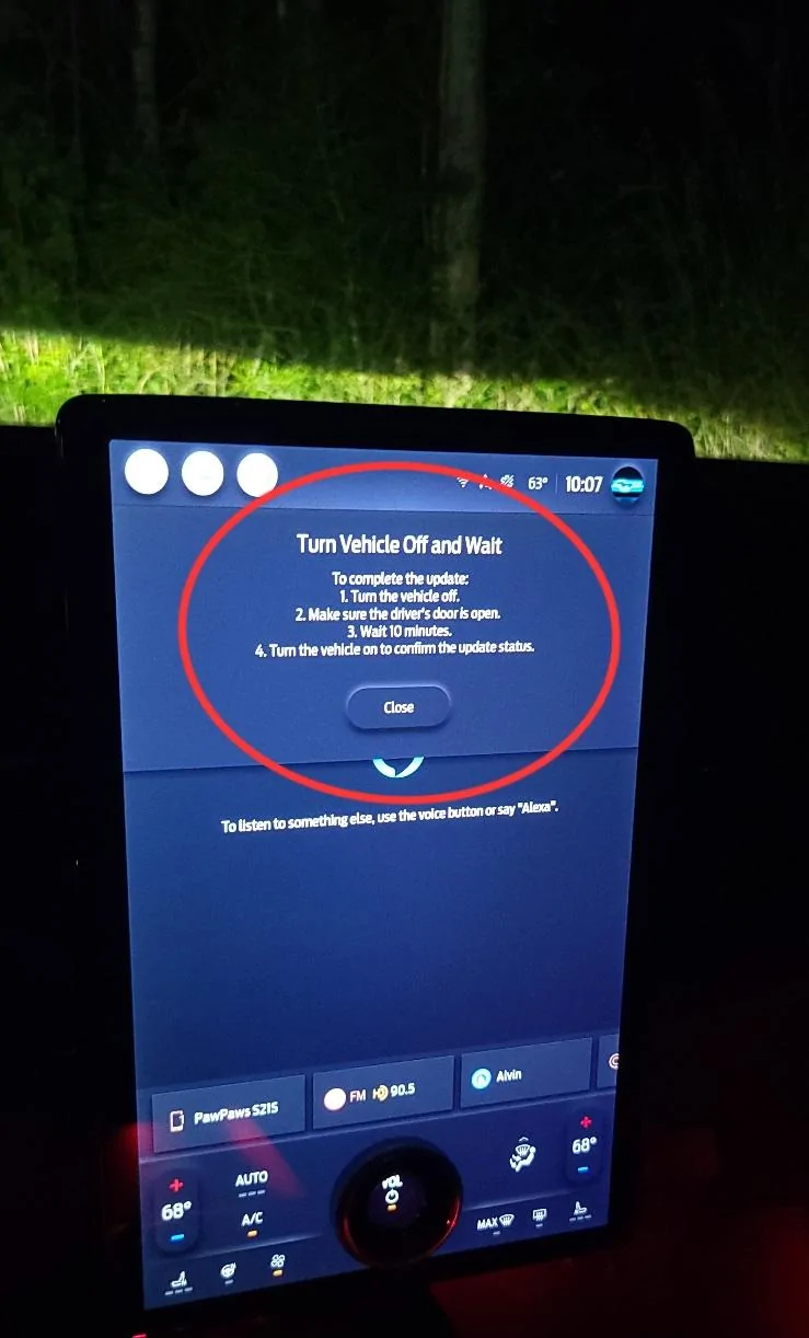

I'm not sure how you were able to change the trucks screen to portrait mode. Is the a forscan edit you did ? ? ?
Wow! It kicked off! That's great another hurdle overcome.
Jesse doesn't let a little Ole problem on Ford's servers stop progress.
He read the log files from an FDRS session and identified the mess on the cloud side with this VIN.
Basically the file size of the downloaded files don't match the file size expected. (in the manifest?) So FDRS would abort the update. Which it probably should. But it's Ford that has the mismatched files in the queue.

In this instance, yes.
Hopefully the car and the cloud will sync up soon and Ford's mess will be in the rear view?
Or you can grab a FDRS license, heck it's cheaper than lunch at McDonald's now, and with 1 scan it will instantly sync up to the cloud.
