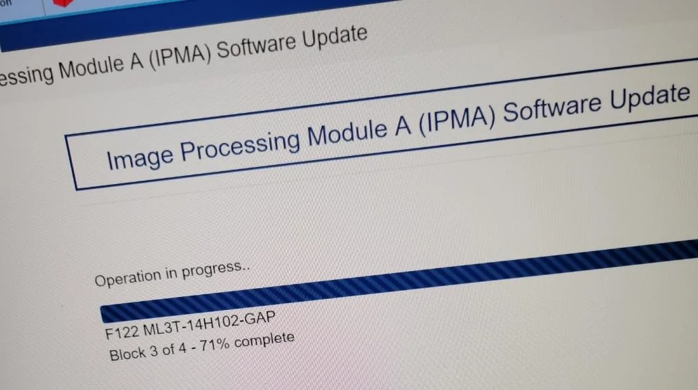

Has anyone done recalibration related work after updating modules?
As an example, after updating my old MY21 truck, my lane centring was all over the place. I was concerned that triggering some of the tasks that could fix the issue would require specialised hardware to complete.
I did. I recalibrated my IPMA using FDRS last month. My BC had my drunk bouncing between the left and right edges of the lane making it seem like I was DUI. Night and day difference after I did it.
FYI: My truck is leveled. When I went to calibrate, it asked me to measure the distance between the top of my front wheel arches and the ground. It warned me to leave the value in there from factory because the IPMA calibration was not intended to adjust for suspension modifications. I ignored it, entered the values I measured, and my truck's lane centering is not on point.
Which routine did you perform inside FDRS and what did it involve? Did you have to drive with the laptop attached?

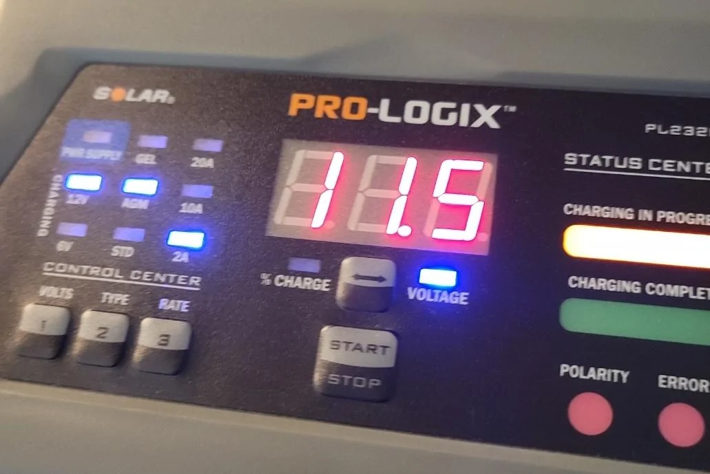

At what point do I need to worry about the battery? The maintainer isn't holding right now.
