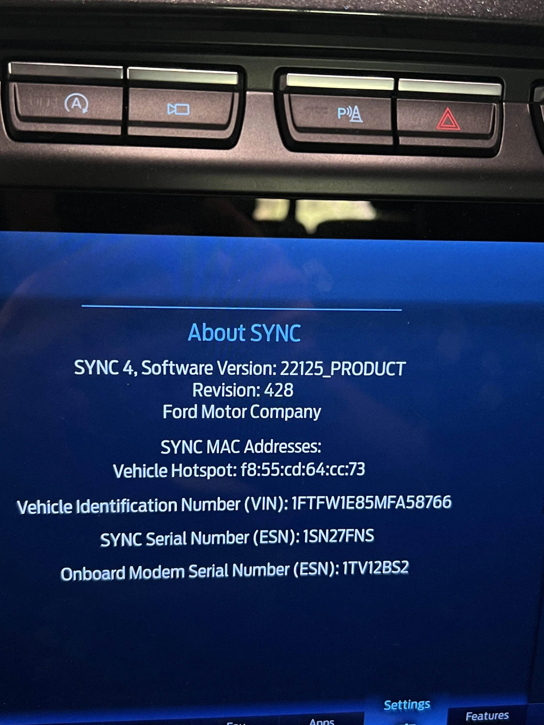

Go to settings general about sync and post a pic of it so I can see what version you’re at

The PMI process failed when they installed the new APIM. That ESN does not match the one on the APIM your truck was built with. However, wait on @Jesse-Infotainment to confirm my suspicions, but this seems very familiar to me.

yeah tht is why I wanted to see what version it was on. If they replaced the PAIM the part number would be the new one and it is not.
Youll want to get that corrected pretty quickly. Or youll have issues you may never get corrected.

Your first order of business will need to get the APIM PMI process completed.

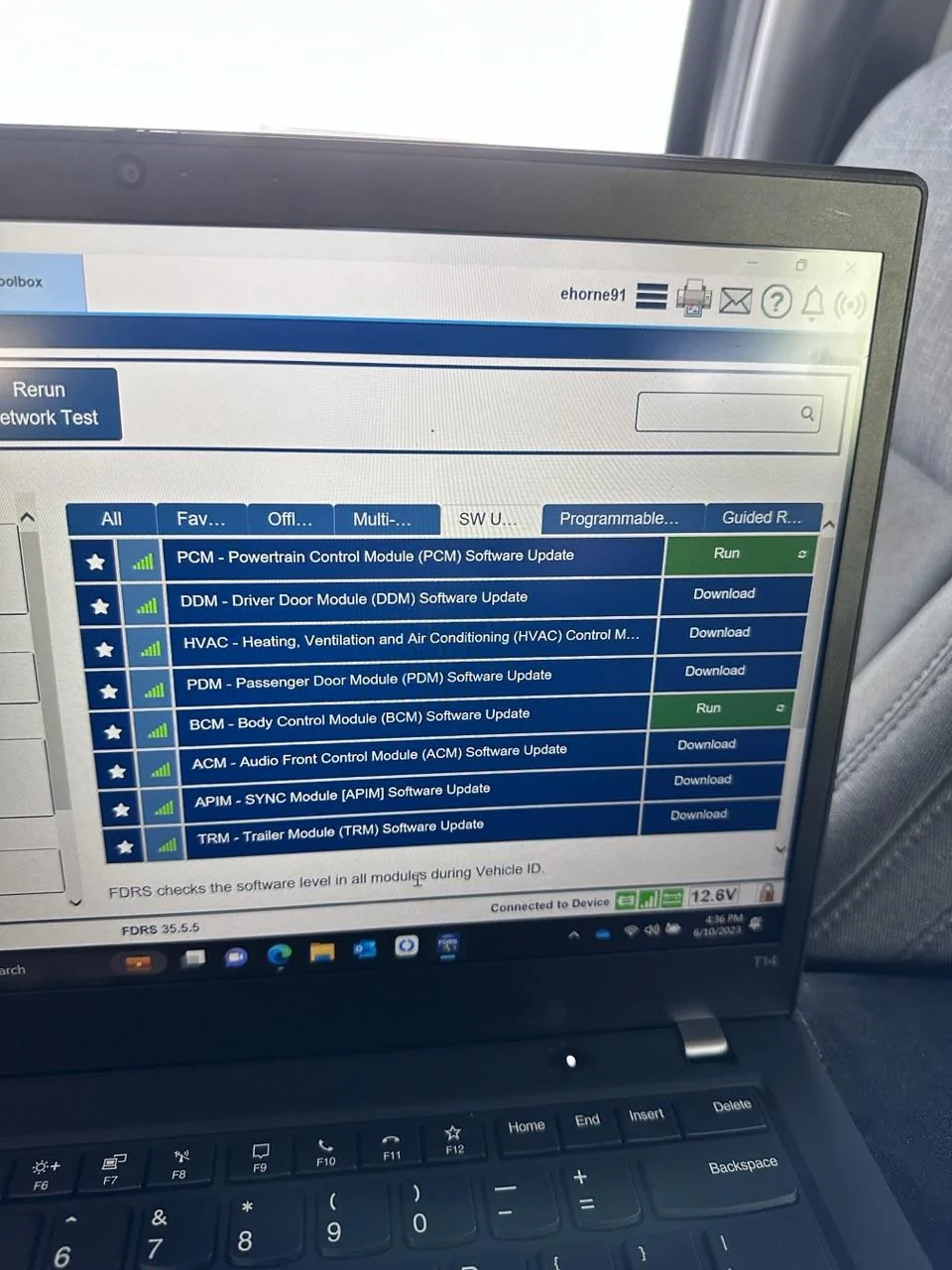

Is the DSP update in FDRS still failing to install, or is it going through for you guys now? Anyone tried again recently?
JEB
Aug 15, 2021
1,985
1,984
US
2021 F150 Lariat PB 502a
It installs. It just doesn’t properly report the installation to the server so it remains in the FDRS queue. I retried a couple of days ago.

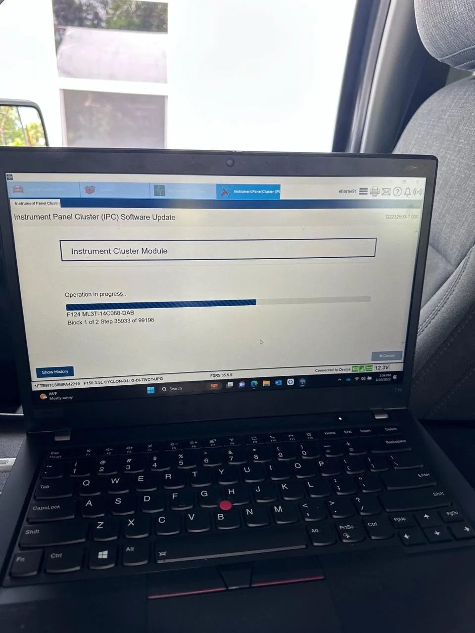

Quick update: statutes with IPC that took 4 hours. Then did Gateway and then TCU and my APIM update popped up after. Starting it now.
Lucky you. It took me 6 hours to update my IPC.
That'll happen a few times. Once you update certain modules, it will trigger other module updates to appear on the list.
