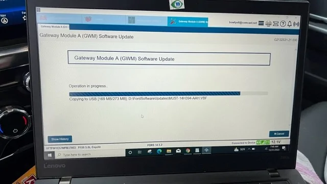

Well A big thank you Iceman77 for his detailed easy to follow writeup. Thank you to all the others as well.
for some reason my work laptop would not activate the moongoose cable or connect to the ford servers. never had a problem with it programming my cars with HP tuners or forscan etc... so I used another laptop and cable activated and ford LIc went through.
I started yesterday about 2pm. worked at it until about 7pm. Then started early 7am and just finsihed up 12:30.
I have full screen Apple car play :) I have the updated sync buttons. but I cant seem to get the unreal screen with Home button working.
I had the 75th anniveray there a few times but after a mater reset it went away.
Also my maps is not showing my road. Its a pretty new sub division but it was showing up before .
It was taxing on the battery I went down to 11.8v at one point. When I stopped the night before. Let trickle charge go all night.
I'll goto forscan pages to see abut unreal theme etc..
Again a big thank you for all this info in this thread and good instructions.
