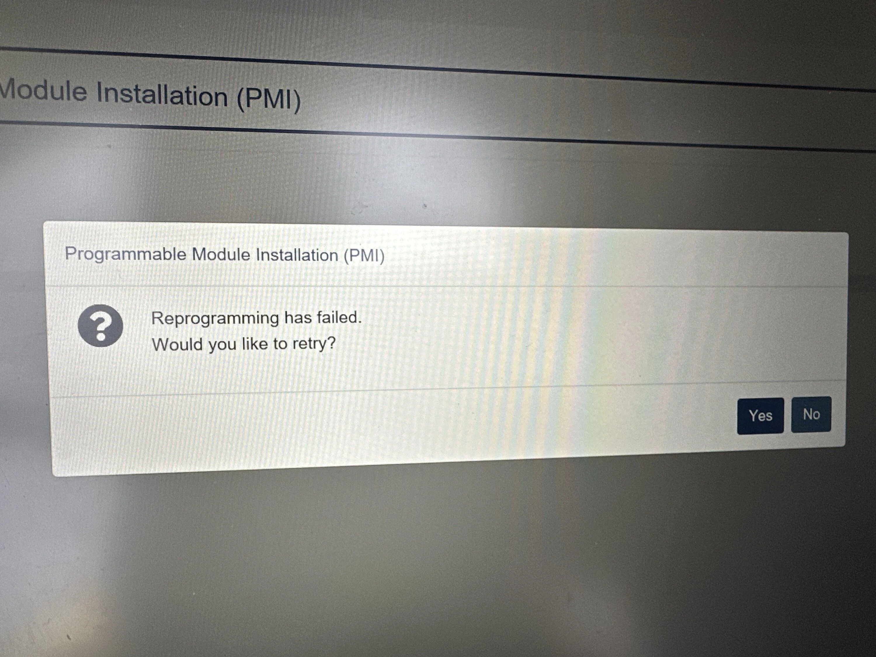

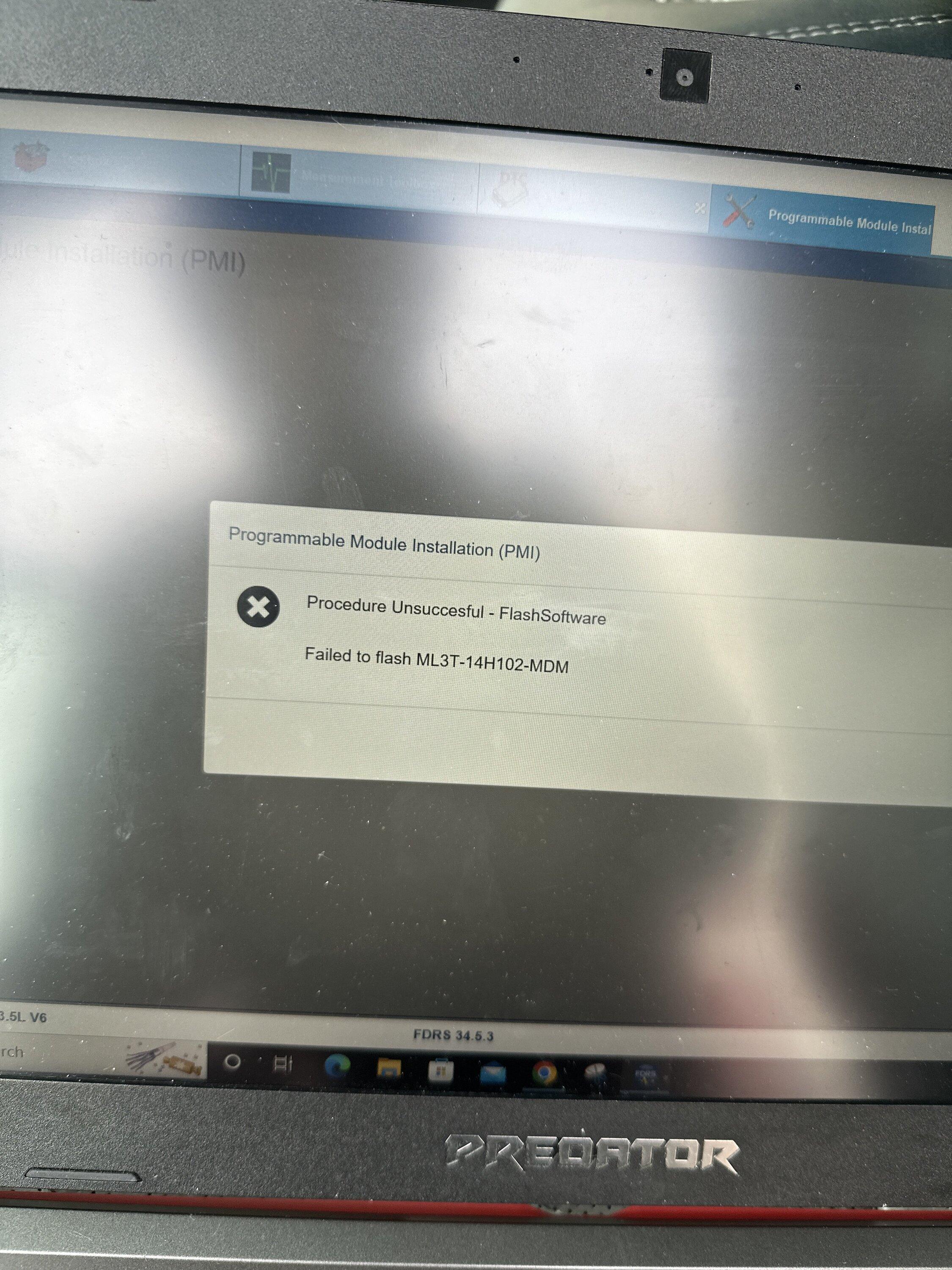

Tried to update IMPA on 2021 F150 and the update failed, now I tried doing PMI to try to restore it back to normal but that fails too every time, anyone have any idea why it keeps failing?
You not using a Nano adapter are you? Mongoose right?

I bought a mongoose plus that's coming in tomorrow to retry but no clue what else it could be if it fails even with that one
Let me know if the mongoose doenst rectify it.. FDRS is EXTREMELY sesitive to the pass through device.
I can get it fixed regardless. Let me know
