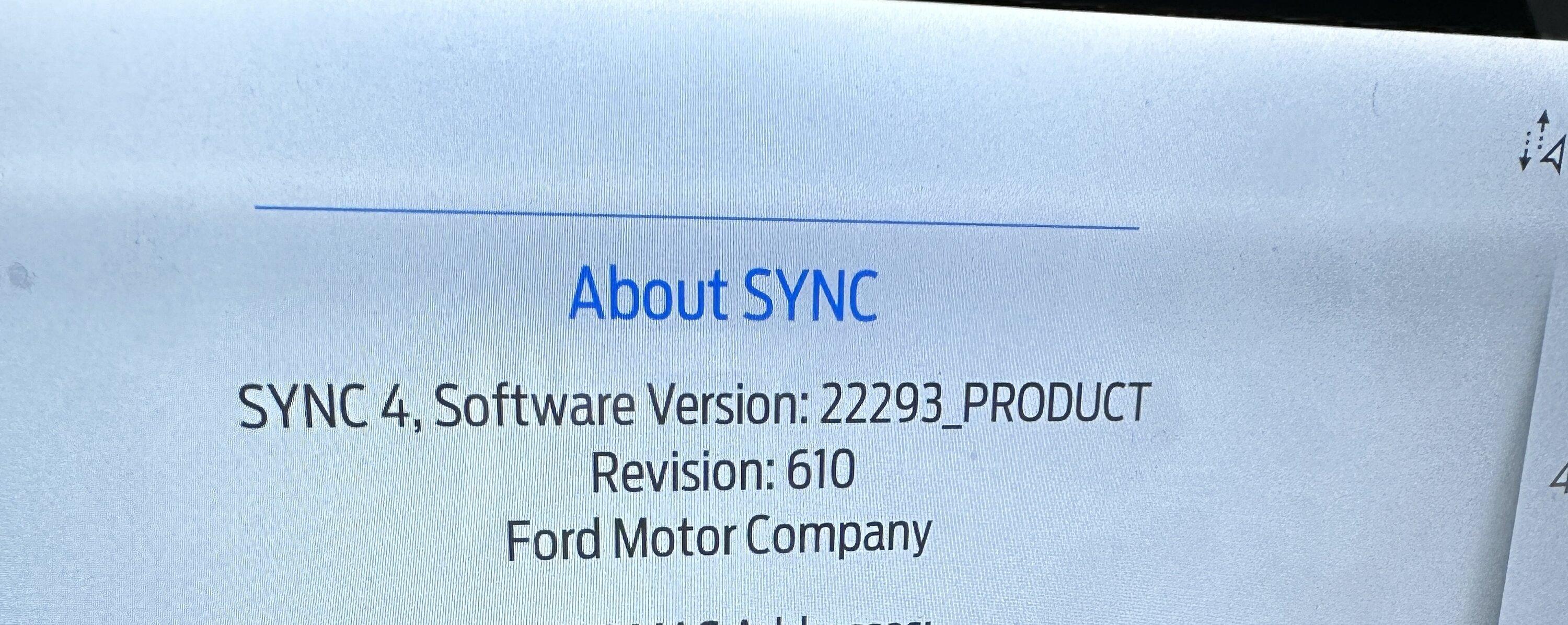

I’m in the middle of APIM update, got the usb in the truck, showing system updating in the top right corner.
With
ignition is ON & Engine is ON, Truck is just running in the garage with the garage door open.
what is the timeframe in this stage?
About 45 minutes

No Luck, retrying the process, removed the USB from the truck, formatted it again to exFat and now copying files back onto the USB 5gb worth through FDRS.

The process. Not seeing any progress.
Usually takes 15-20 minutes for the first step, then the 10 minute shutdown, then another 10-15 minutes. Are you leaving the truck running (versus power on, ignition off)? It should be running for both phases of the installation.
