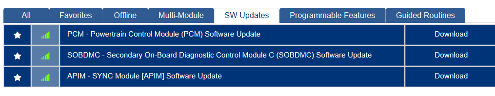

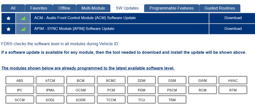

Thanks that would be great! 90% of the time I’m only using one screen, sometimes it’s Spotify on both left and right. But there are times when towing I would definitely switch out off full screen for the side card cameras and nav. Also, the more I utilize this Mongoose, the more I can justify spending my kids Christmas present money on it.
Hmmmm
Since I was already logged in, I entered my VIN not expecting.......
