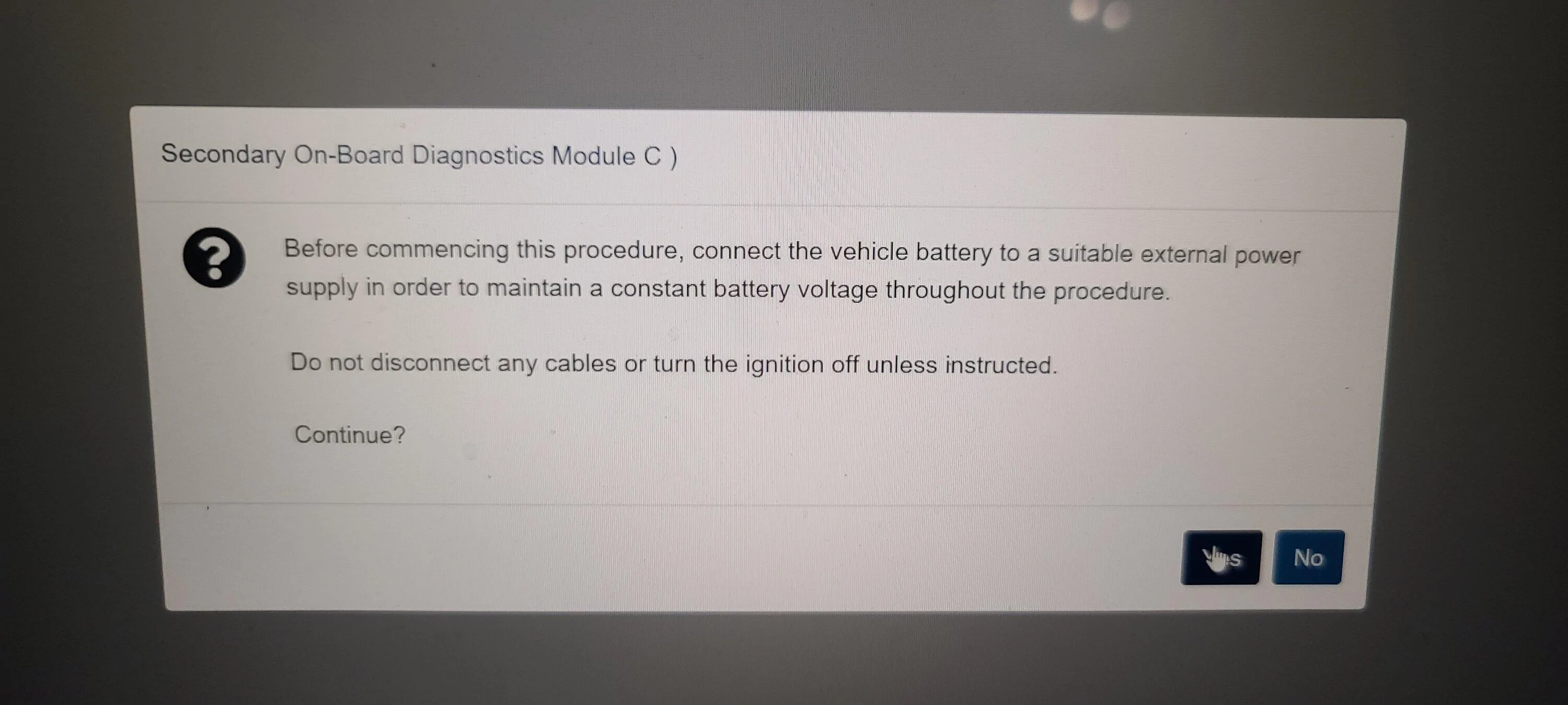

Turns out the PCM update is not stand alone.
Ford F-150 ECU module programming guide using FDRS SNAKEBITTEN112322beforepcmalert
It was tied to the SOBDMC
Ford F-150 ECU module programming guide using FDRS 20221123_175626
I'll be doing the APIM now, although I'm already at
Ford F-150 ECU module programming guide using FDRS 20221123_174659

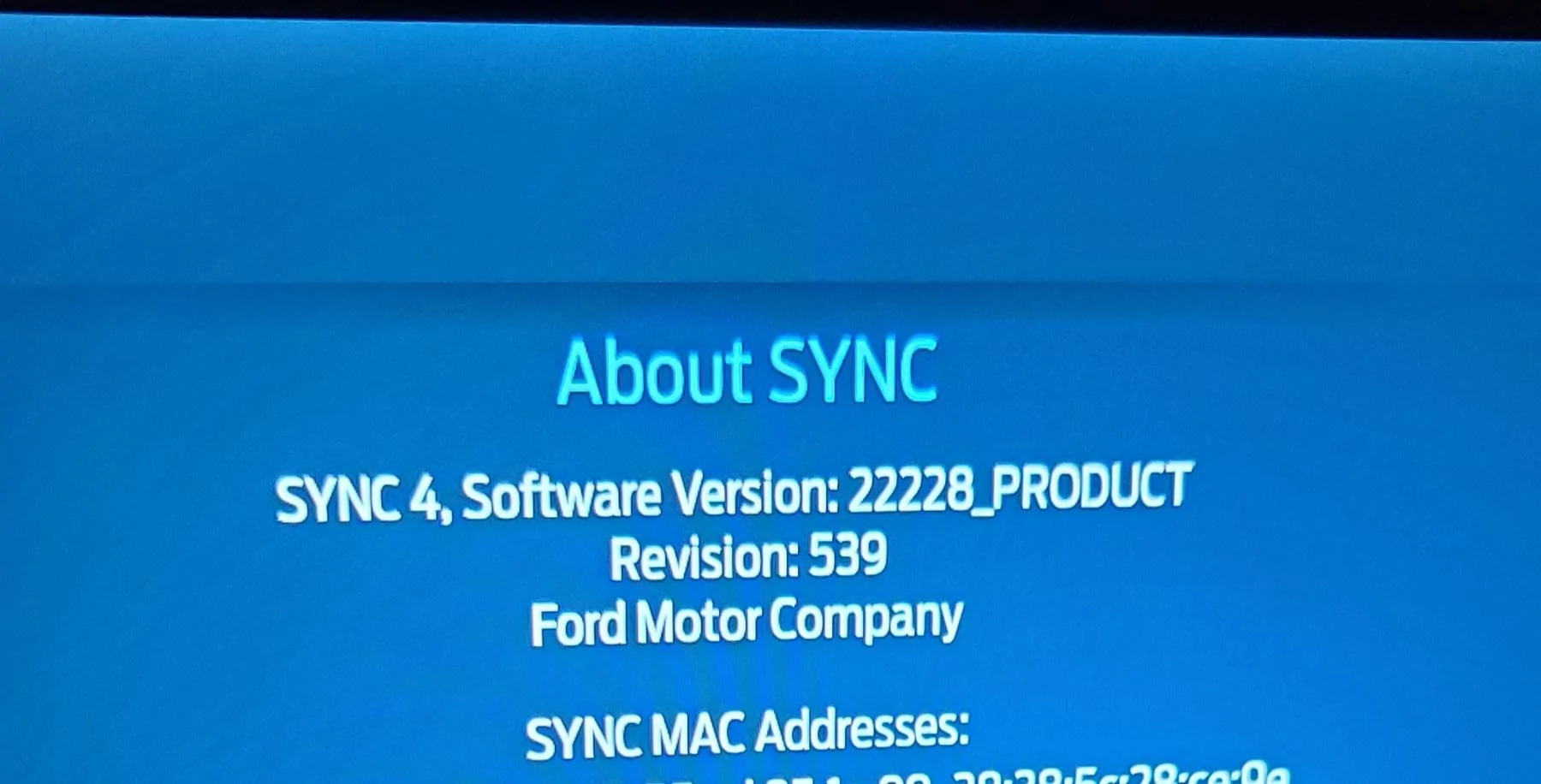

Was I not paying attention and missed that there's a later version than 22228?
I'm getting so old. Lol
Yes 2022 has 22293 available as of yesterday

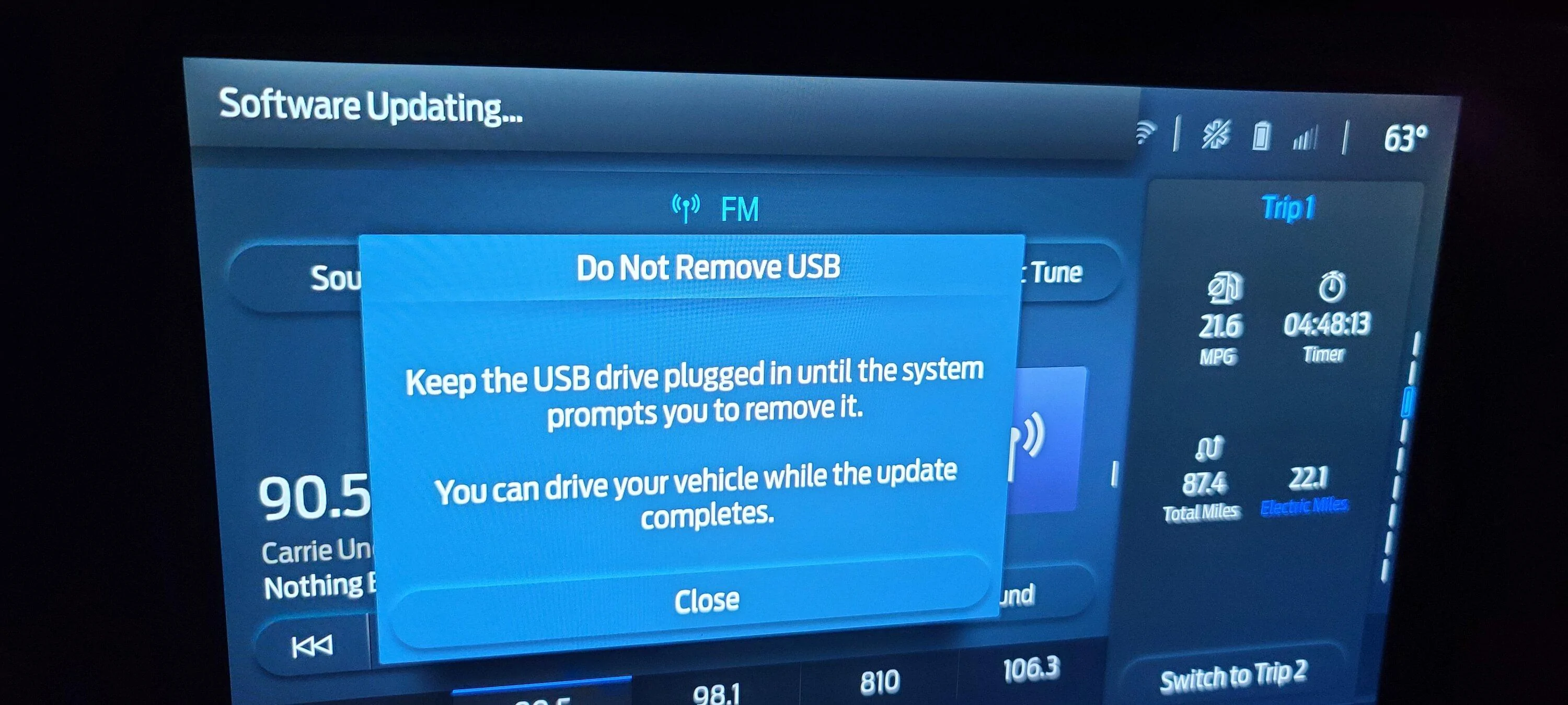

Any idea of what the update contains? Or is it just a generic “bug fix” update?
No idea. It is 5.7gb. No noticeable change. I haven’t really had issues with 22228. Also they had finally unified the trucks and here they go. Fracturing it all up again
5.7 Gigs wouldn't seem so HUGE if Ford didn't throttle the download so much. Not to mention the slow process for copying files to USB.
That is so dealers can charge more for updating customers trucks when it is not on Fords dime...lol

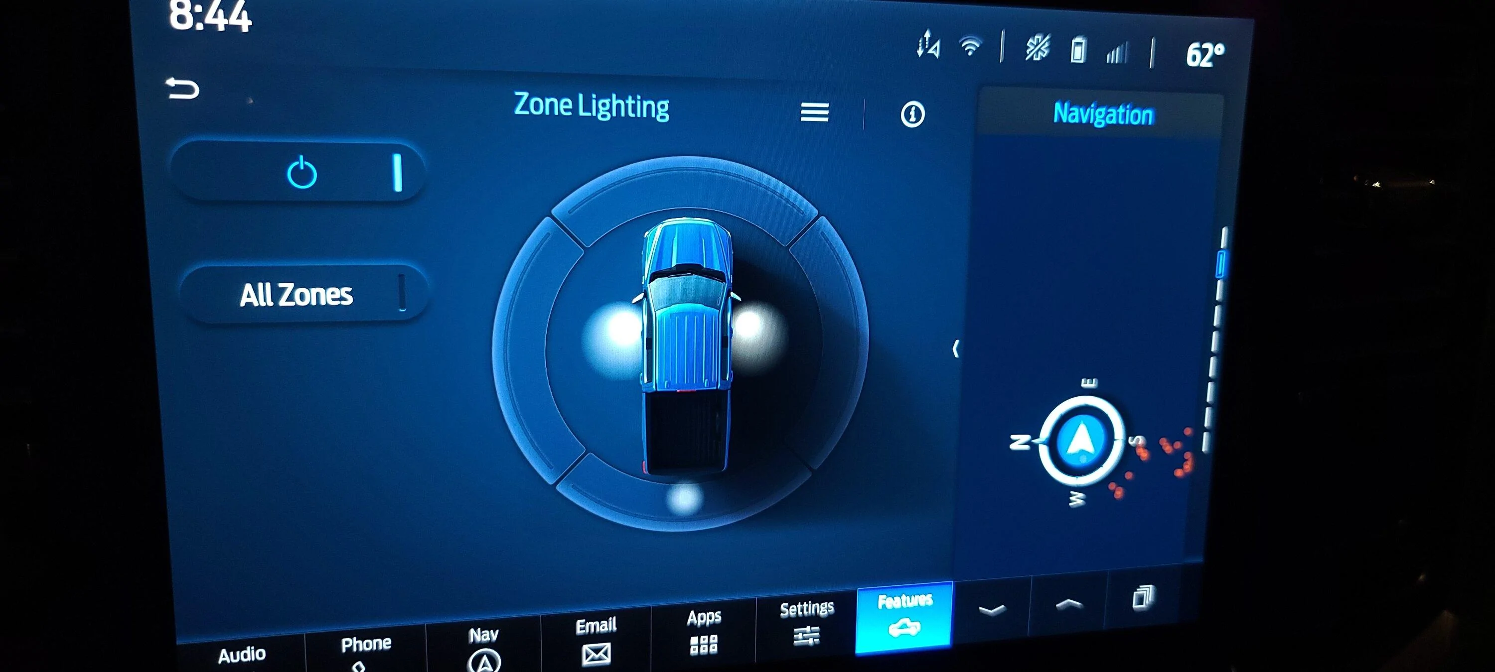

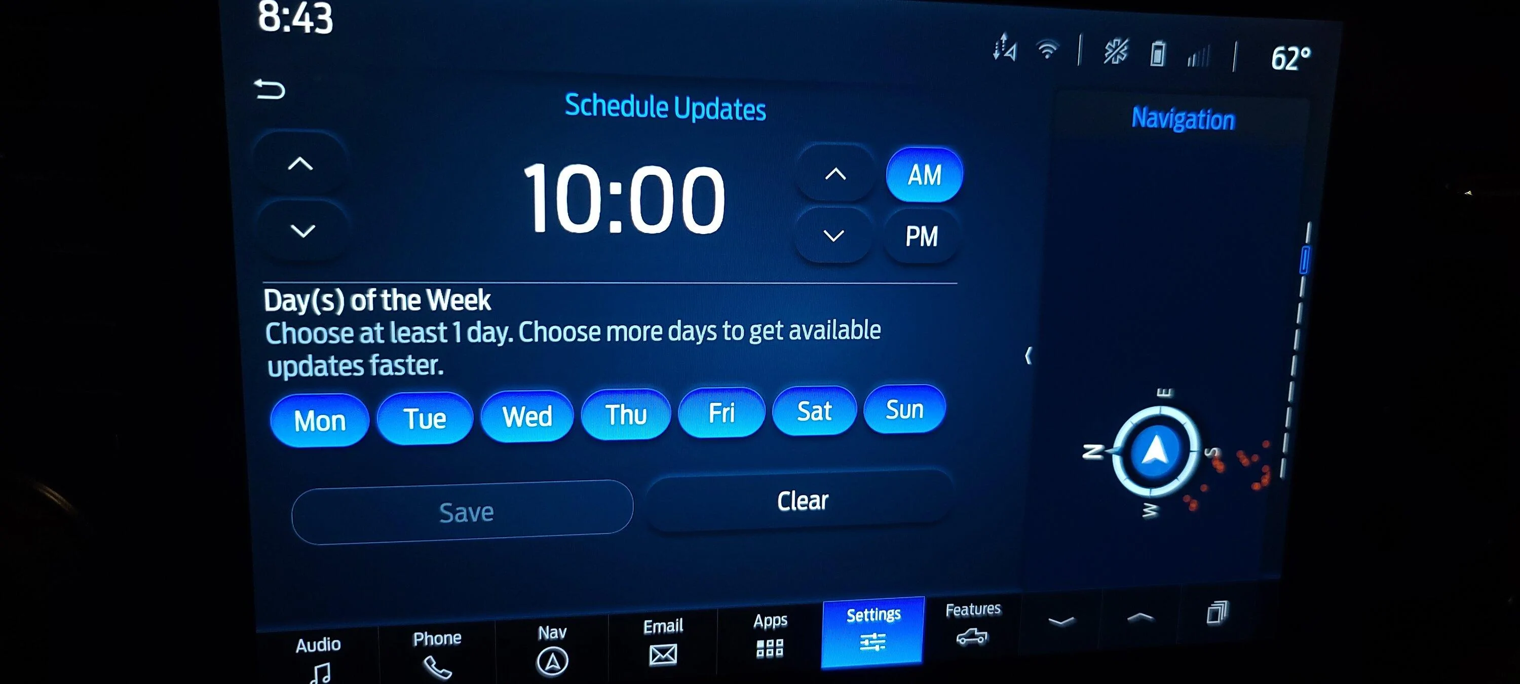

So, looking for evidence of what ~6gigs (compressed) might have included.
Are these graphics details exactly as before?
Ford F-150 ECU module programming guide using FDRS 20221123_204109
Ford F-150 ECU module programming guide using FDRS 20221123_204354
Ford F-150 ECU module programming guide using FDRS 20221123_204439
Zoom in
Seems the shading has changed and the 3D effects on some objects/buttons are altered from 22228?
I have 8 hours of driving tomorrow. That's time to browse around for anything new
Zoom in
One thing to check is to see if the balance/fade misalignment when using UE has been repaired. If it has, then you’ll know for sure some graphics work has been done.
