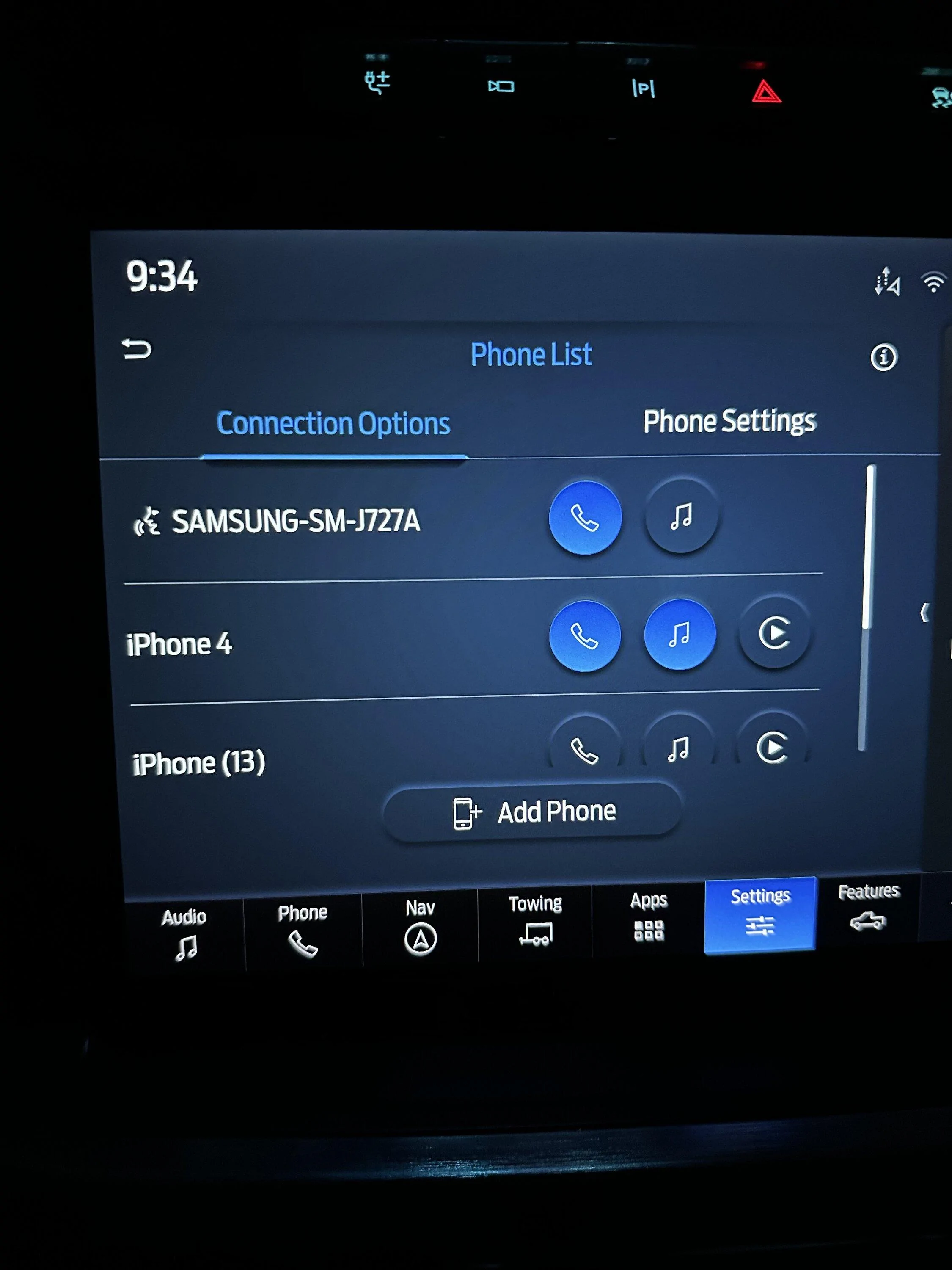

Thank you! Yes it is. Would be nice if they added the power up information to this screen to make it a little easier
I’m less concerned with the update itself than wanting to get the most out of paying for the 2 day license. Also hoping it will help me get future OTA updates sooner in the future but probably wishful thinking.
I also confirmed I can connect multiple Bluetooth phones simultaneously like was listed in the update. I never tried this previously to know if I could or couldn’t
For whatever reason FDRS updates don't offer any correlation to power up updates, although the software is exactly the same. If a dealer does an update the customer ends up with new software but no indication of the new features that the software has, such as the dual phone capability. I believe your now at power up 3.5.5 since you completed the TCU update as well, good luck!

Looks like you have a newer bluecruise map. Haven’t seen the April 13th date before.

Is a module update required to extend that date, or can Ford just push a date extension?
Its the module update. They sent it out in September. Then they unified all the trucks and sent out another gateway update for Alexa. They will send one out every three months.. but yes its apart of the Gateway update and can be sent OTA.

roger that, thanks for the info. I need to check my map date, I don’t think I have a ‘23 date like @m_bt54 has.
Everyone should have the same exact date as of now.
10-12-22
Mewaning December 10 2022.
I am going to pull his vin

He has an AAH file for BlueCruise maps. I do know Ford was having an issue with the date not changing for some . Maybe they released a new update to fix it and it also extended out the BlueCruise for a longer period
10-12-22
I didn’t intend to cause this controversy by posting my screenshot!
All I was really looking to do was get full screen CarPlay and figured I paid for the cable and license so I might as well apply any other updates that were available. I didn’t even realize I had updated BlueCruise until someone noticed it in my screenshot.
Its not a contriversy.. Its good to knwo. I wasnt aware they had released a new file. THe package is still the same but they updated the file to have a new date.
Your truck go tthe ota THE 13TH OF oCTOBER.
Im glad to have seen it. I wasnt aware. I am glad I do. i am going to try and see if I can get mine updated.
