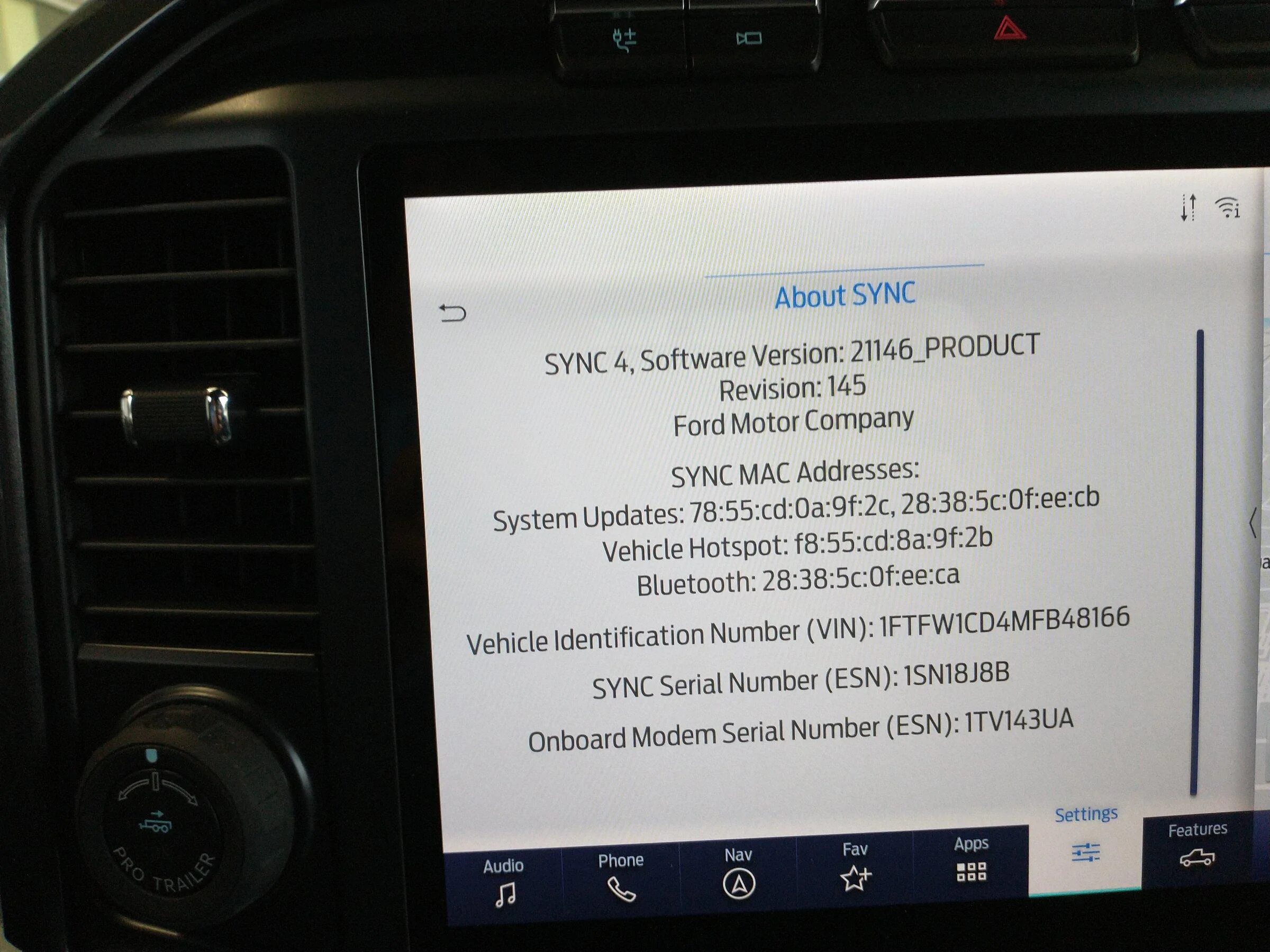

Hey all,
Brought my 2021 Job 1 truck in 2 days ago to the dealership to attempt to get OTA's updating (and perform recalls 22B08 and 22S17) and just got it back. They ended up replacing the GWM as well as successfully performed the APIM recovery (TSB 22-2150 I believe). Been an issue since October when the dealership attempted and update and broke it - updates were greyed out and was stuck on 1.7.1.
Two questions:
1. What version am I on now (21146_Product Revision 145)? I get confused with how it aligns with https://en.m.wikipedia.org/wiki/Ford_Power-Up_Version_History.
2. Typically how long before I receive an OTA after the fix or am I still stuck?
Before:
After (today):
I had the dealer repair mine in late March -- repair the failed 1.7.1. Like yours, mine updated to the same version.
In about 2 weeks, mid April, I received the 2.1 update, with no change to version. Since that OTA update, I have received 4 FAILED OTA updates for 2.1.1. Going to the dealer 6/6 for him to manually update the GWM/
