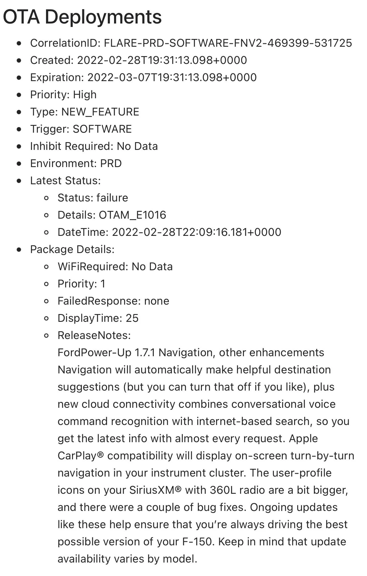

I’m still waiting for a miracle. I haven’t had any OTA updates even try since last December and the 1.7.1 update. Pretty sure my truck in PTS is also borked. Last time I had a PTS subscription it wouldn’t even show me the connected diagnostic info or the OTA info.
Anyone with a PTS subscription care to have a look for me?
1FTFW1ED0MFB66211
1FTFW1ED0MFB66211
Is your update button grayed out?

Okay...I'm lost now...you're fully up to date using FDRS...but you think you're missing out on an OTA? :unsure:
No it’s not than I’m missing out on any as I update manually but it’s not seeing any change whatsoever in PTS on the status of OTAs. One would think that since the truck has moved past 1.7.1 that if a new OTA was pushed and I hadn’t updated manually yet it would have at least tried.
I still show 1.7.1 as failed in the scriptable widget and none of my dates for deployment, expiration etc have changed.
