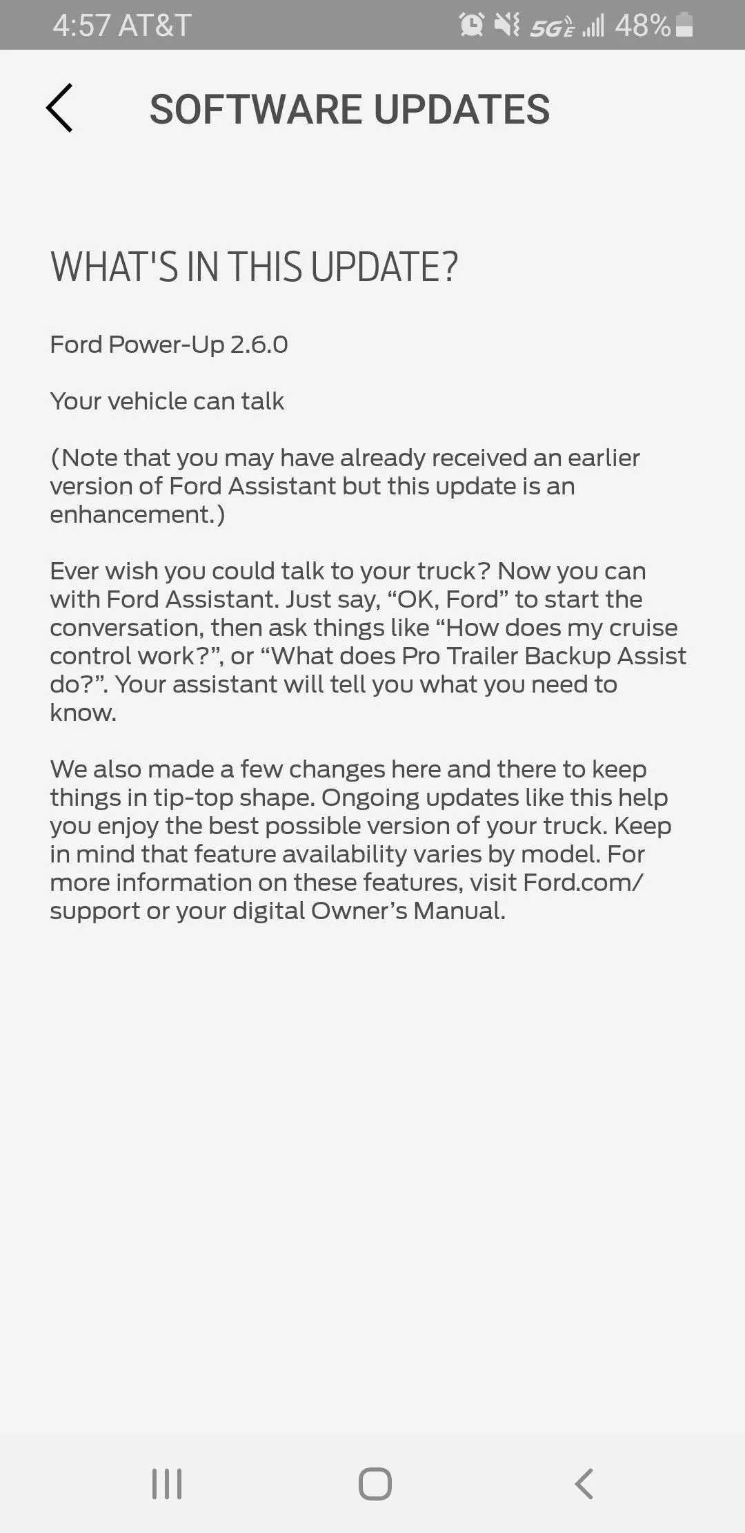

Got a question that somebody here may be able to answer. A member on the Mach-E forum who's APIM was 'stuck' due to an OTA used the USB method to get himself unstuck, rather than doing the whole TSB 22-2150 procedure with the various cables. He now has a concern that since he used the USB method to get unstuck and updated (don't know what version he's on currently) that he won't be able to get OTAs (says 2.6.0 has failed repeatedly) because corrupted data is still in the APIM even though he did get unstuck using the USB method.

Two members of both this forum and the Mach-E forum stated in separate posts that it was their belief that they overcame their 'stuck' version of the APIM software using the USB stick programming method (instead of following the TSB 22-2150 procedure with all the cables etc.) and as a result they suspect that although their APIMs did update to get past the 1.7.1 version, that they still may have some corrupted data bits that weren't cleared out using the USB stick process, and so it was felt that this is the reason they were not getting new OTA updates (I think in both cases they were seeing OTA 2.6.0 failing repeatedly).
