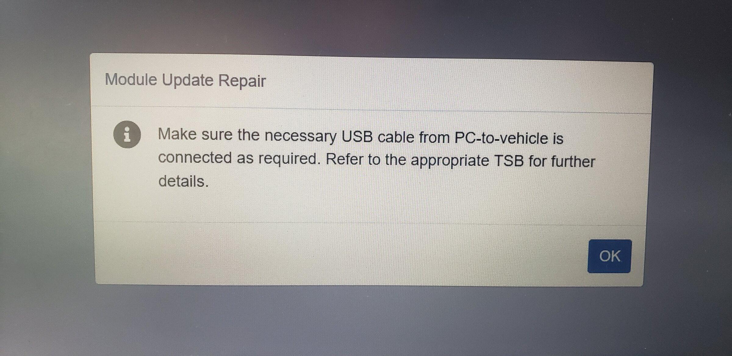

no, cant get past the fastboot issue. something wrong with drivers or something? maybe an old laptop?

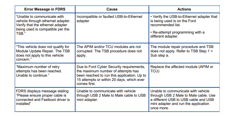

Did you check the latest TSB put out by Ford? They mentioned which cables worked and which brands did not. I'll dig into it more once I get my equipment. Good luck.
Edit - Attached is the latest document from Ford from Wed.

Hey Steve - The table below shows the various error messages and actions on page 18 of the TSB. I think your error is the last one.
