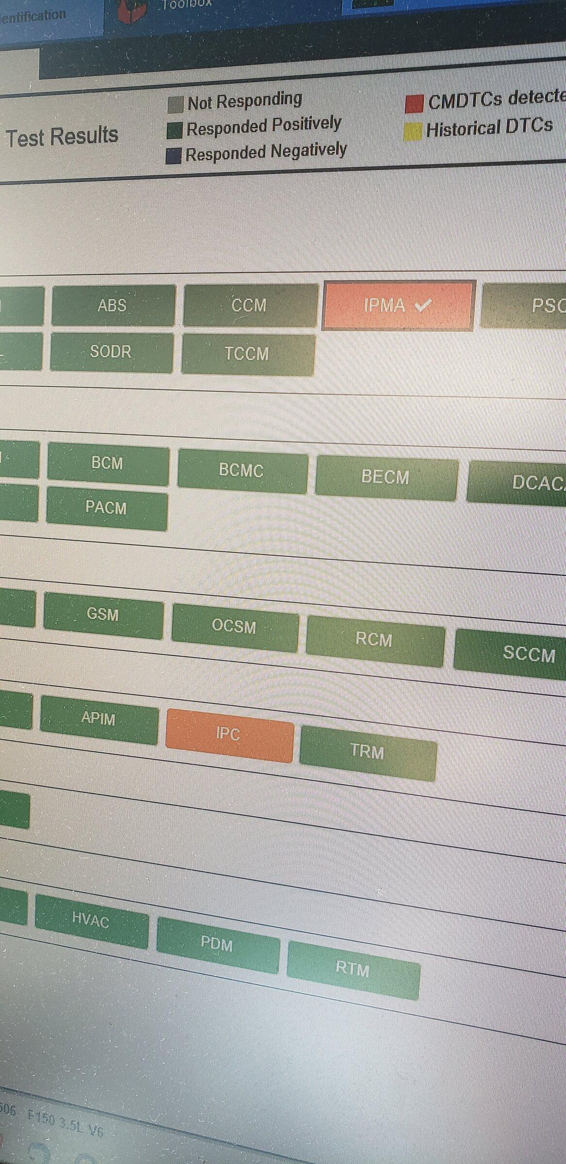

Yup getting GWM update issue also...so i went through the process waited over 10 min came back turned ignition on it would not show on sync as update successful anyway long story short got the same massage could not communicate with VCM now GWM is still in orange did self test and it cleared reran network test its back in orange ran self test again now i have DTC

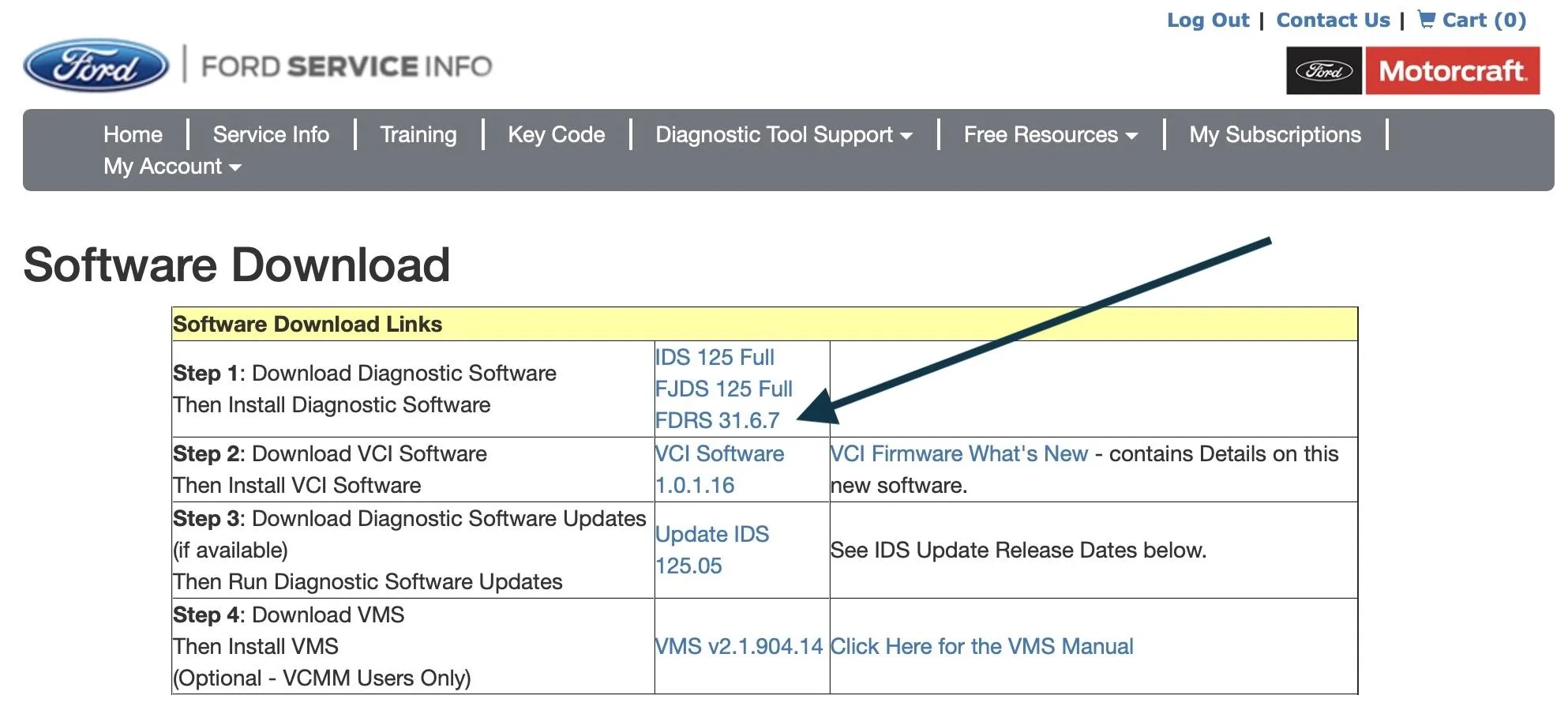

Getting ready to take my turn at TSB 22-2117 to unstick the APIM/TCU. Have the hardware including the Mongoose-Plus. About to load the software. All the online posts simply say download the FDRS software. When going to that page there all multiple steps listed with many software downloads. Just want to confirm that FDRS 31.6.7 is all that is needed.

think i got some dtc too. should i resolve these first?
That is all you need.
Those will resolve as you update. If you’re still getting the “data” error on the GWM then it needs to sleep overnight. That did it for me.
Thanks. Has anyone just done the SB to unstick the APIM, then let nature take it's course on future OTA updates. I have seen reports that once unstuck the updates roll in nightly.
