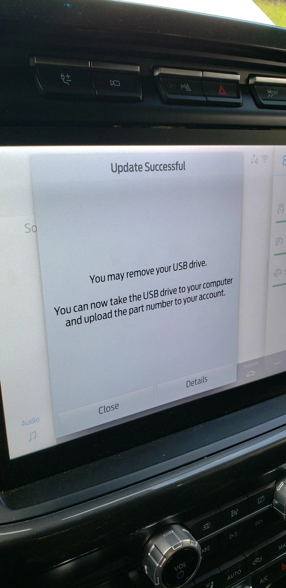

started from the bottom now we're here. thanks for everything guys.
You are the latest example of why dealership techs are a fail. You had to be far more tenacious than the average tech, who is already outside their wheelhouse using FDRS, would be.
And you also are the perfect example of yet another caveat. Didn't you have to use a second pc?
Anyways, congrats. You are going to get there. It won't necessarily be smooth sailing all the way to the end, but you likely accomplished the toughest update of them all. :)

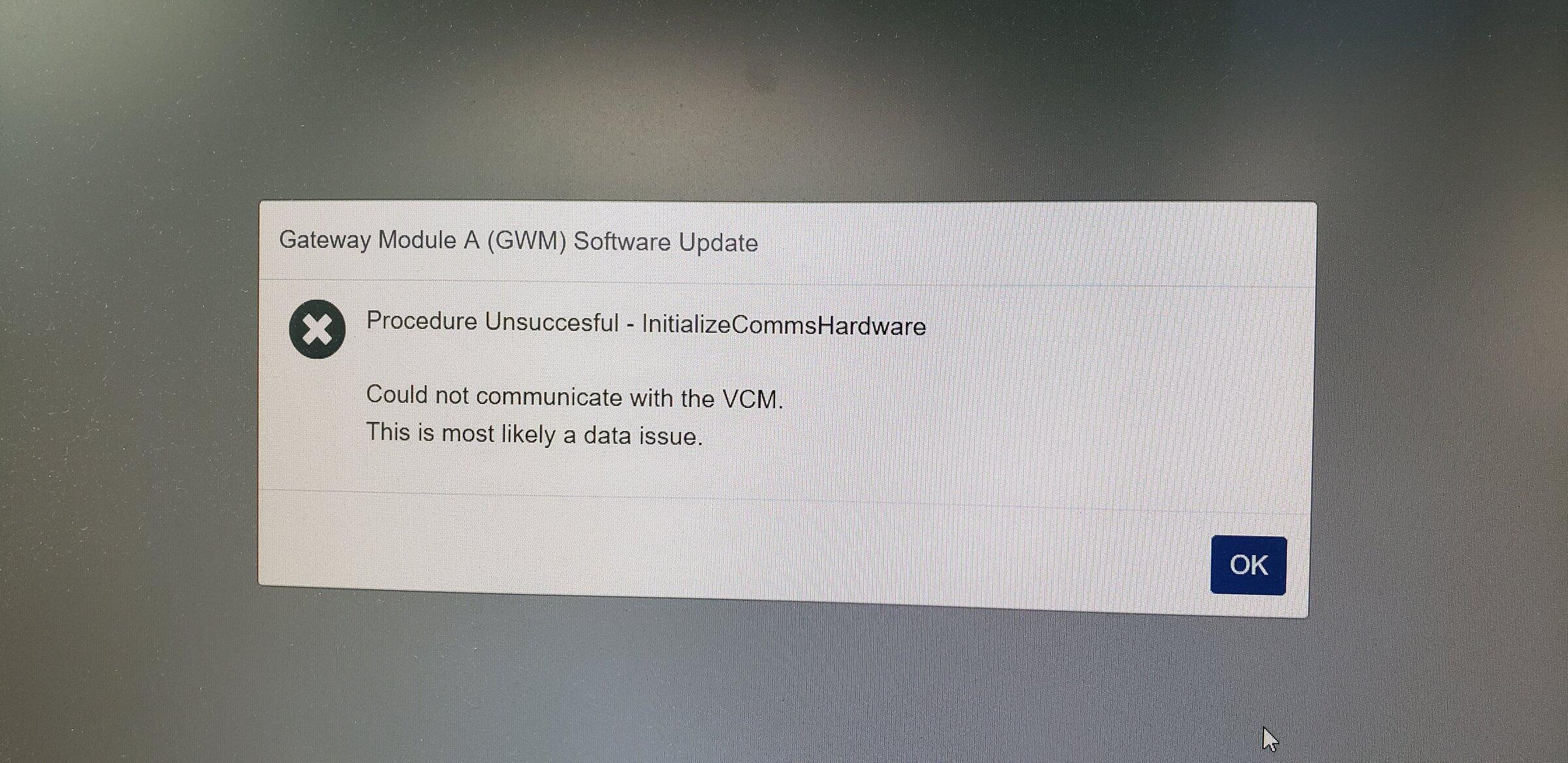

hmm. gwm update #2.
Communication errors usually had me shutting down the truck, shutting down FDRS, and then starting truck (koeo) and waiting a couple of minutes before running a fresh scan.
Or put another way, after any fresh Key-on/Engine-off event, I pause before a scan. Give the truck a chance to finish all the network handshakes before interrupting the network.

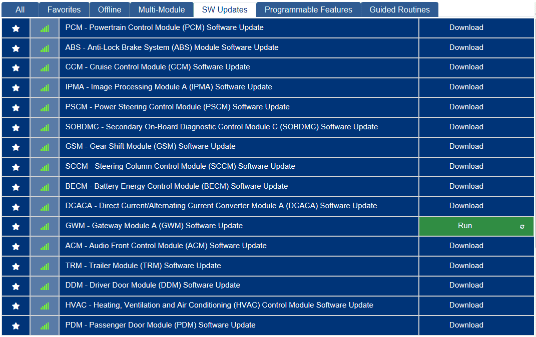

me again, one more question....sorry if it's been covered. now that i am out of frozen purgatory....can all of these updates OTA themselves moving forward? or are some of them going to be mongoose or dealer only? i might buy a year license. ive done a handful of updates and the list hasnt gone down. ? still looks like 16 to go. again, thanks for all the helpful replies so far peeps.

no change. hmmm. still getting cannot connect to VCM. i cant move on to the rest of these until this is sorted, eh?
and i shouldnt need to do the multi module repair again, right? that was just to repair APIM for the frozen updates?
Ford F-150 ECU module programming guide using FDRS updates
